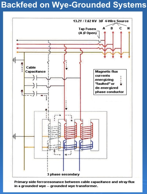

Does anybody have experience with a transformer being damaged by ferroresonance? Particularly where the condition was interrupted fairly quickly and failure wasn't catastrophic? I don't yet know the details of the transformer failure, but apparently there was considerable current when it was switched on, phase at a time, but not fault level current. Transformer is wye-wye, H0 and X0 internally connected and grounded; on a 13kV feeder with lots of underground cable. If the transformer had had a delta high-side rather than a wye, I'd be pretty certain it was ferroresonance; but it's much less common for grounded wye high-sides. Thanks.
There have been several papers written and extensive testing on the newer no load losses five leg silicon steel wound pad mount transformers. It seems to happen especially heating them up one phase at a time.
Never had it happen though...
Have had partial vacuum flashover when taking the elbows off.
Thanks for the diagram, it's similar to an illustration in Blackburn. I'm more interested in a description of the transformer damage that might be associated with a ferroresonant event. I've got one that where ferroresonance seems most likely from the description of events, but I'd like to correlate (or not) that with the description of the damage to the transformer.
