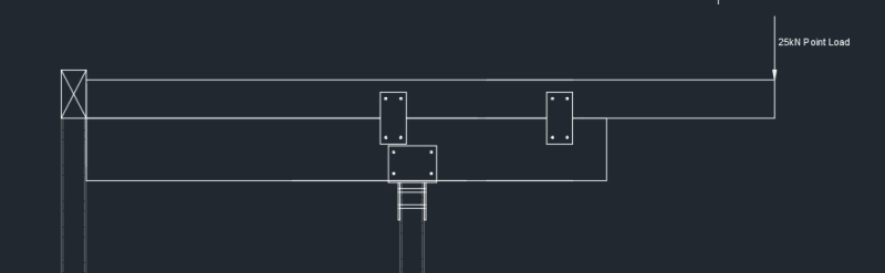

This is really uncommon to me however I have tried my upmost and was wondering if you would share your thoughts.
I have 2 different sized timber beams cantilevered both which are supported by steel column. The top timber beam overhangs the bottom with a distance of 2.1m from the steel column. I have come up with the following connection. I used 20 M12 and the utilization is 0.89.

What's the question here?
I'm not seeing why the bolt capacity parallel to the grain is that relevant here? The loads are transferred vertically between the members and the post, and vertically between the two members aren't they?
Maybe too many bolts... they may cause splitting if the lumber shrinks.
What’s the question? Are you aiming for composite action?

What methodology would you use to fix both of the timber beams together?
What forces would you consider?

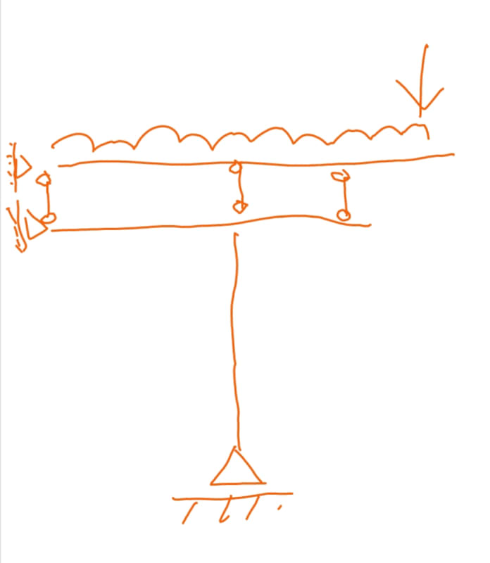

I usually check this type of thing with two separate members separated vertically by a nominal distance, but linked vis some rigid links at the points where you've connected them. This allows you to design each member for the loads being transfered between the two members. The load in the vertical rigid links can be used directly to design the transfer forces at the connection points.
The key is you basically have two separate members simply sitting on top of one another, not a 580mm deep composite member.
If you're trying to make a single member that's 580mm equivalent depth, I don't believe you can really do it connecting via bolts as shown. Composite action is undone by bolt holes being oversized typically.

Bad sketch on phone follows. Hopefully it gives you a better idea of what I meant.
If you are trying for composite action, it's best to use adhesive. You may have difficulty finding technical data. You can use steel shear plates and glulam rivets. If strength is provided by the individual members you can use a couple of straps bolted to each member... use single bolts, one on each side of the joint.

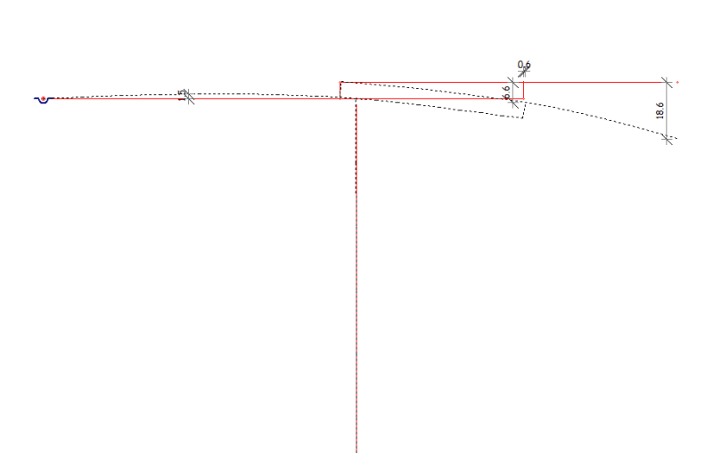

I followed your approach and I am quite happy with the member sizes.
This is a model

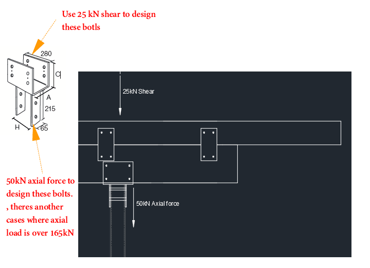

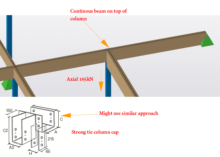

I think to use similar connection to strong Tie column cap. However, in one case I got high axial force on the column and I don't think the bolts would be enough. So I was thinking to just use the top column cap welded to the column without the bolts below .
This is how I plan to fix it.
Please give me your thoughts
If you glue the two beams together for composite action you will get less deflection but you will also have lower load capacity at the end of the cantilever due to the stress concentration where the beam stiffness suddenly increases.
I'd move the left plate over a couple of inches and move the the bolts closer together... a couple of inches from the interface.

Show the loading diagram, particularly the one where the axial load to the column exceeds 165kN.
Why are you selecting this odd arrangement of beams?
BA
I’d run the top beam further into the backspan. More like that agwnt666 showed.
The client doesn't want the beam below sticking out. So I have to add beam inline with the roof joists and can give extra support. That cantilever is carrying only 25kN point load and the self weight.
The other case where I got 165kN is at a T junction
I may use T junction but I dont think 2 bolts would be enough at the bottom. Please advise

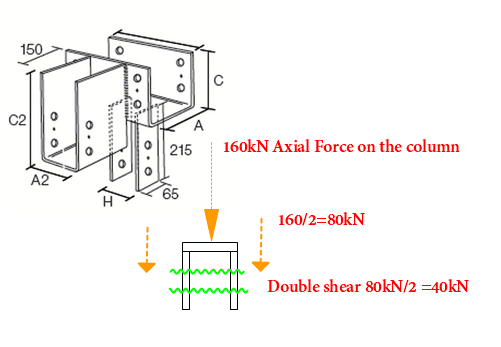

I am also concerned about the T junction connection as I got high axial force 160kN in there. I did some check as you see below, but I am not sure if the connection is designed using this approach. I used M16 grade 8.8 and plate thickness 12mm.
Using bolt size 16mm
Bolt double shear capacity 118kN > 40 KN
Bolt bearing capacity for 12mm plate thk = 88.3 kN > 40 KN
Please give me your opinion in case I missed something
For the downward forces, they are relying on bearing of wood on steel. The bolts are only there to hold everything in place and transfer any uplift loads.

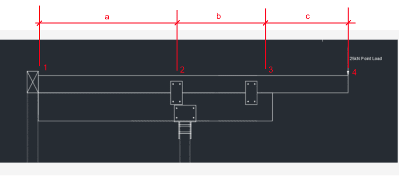

See diagram below. Point 1 is the face of column (or more correctly, the centre of hanger). Point 2 is the centre of a plate connecting the two beams. Point 3 is the centre of bearing area between the two beams. Point 4 is the centre of load application. Dimensions a, b and c are as shown below.
The plate just left of point 3 holds the top beam in place but does nothing structurally.
Red text below has been edited.
In the absence of plate 2, the top beam would be supported at points 1 and 3. Neglecting beam weight, the reaction at point 3 in kN would be 25*(a+b+c)/(a+b). The reaction at point 1 would be 25*c/(a+b) upward. Between points 1 and 3, the top beam would arch upward relative to a straight line between points 1 and 3. Point 3 would deflect downward and the lower beam would deflect upward between points 1 and 2. The amount of arching of each beam depends on their stiffnesses. If the lower beam is the same width and 1.5 times the depth of the upper beam, its stiffness is more than three times as stiff, so the upper beam would never come in contact with the lower beam except at points 1 and 3.
If a plate is included at point 2, tying the two beams together, that plate would be in tension, the value of which is indeterminate. This means that the other reactions are also indeterminate.
Nothing I have said above should be a mystery to anyone with an elementary understanding of statics.
