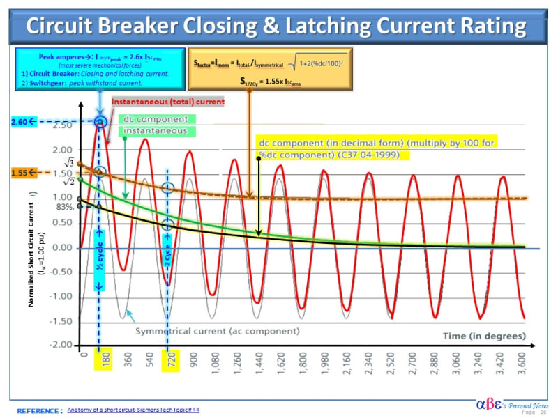

I see the the confusion. We have symmetrical (3P) and asymmetrical (L-L, and L-G) faults, and we we have the symmetrical and DC components of asymmetrical fault current. These are not the same concept. Perhaps balanced and unbalanced are better terms for fault types when discussing both concepts together.
Allow me to offer the following comments:
1) Any circuit breaker shall be able to withstand the force and heat generated during a short circuit.
2) Circuit breaker is tested at rms symmetrical value and a given X/R ratio prescribed in the standard.
3)The circuit breaker shall be capable of closing and latching any power frequency making current whose maximum peak current.
4)Circuit breaker requires closing and latching current under fault.
[sub]The Peak current for closing and latching is determined by multiplying the symmetrical interrupting rating current on the nameplate (k[sub]Arms[/sub]) by 2.6 (older std x 2.7) for 60 Hz or 2.5 for 50 Hz.
• The momentarily current can be obtained by multiplying the symmetrical interrupting rating current on the nameplate (kA[sub]rms[/sub]) by 1.55 (older std x 1.60) for 60 Hz.[/sub]
5) Relaying needs to ensure that the backup breaker is tripped before the front-line breaker exceeds its short-time rating.
Below is an illustration of the SC. The 1/2 cycle region is indicated with the peak and momentarily multiplication values. I hope this contributes to clarifying the subject.

Nice diagram that explains it pretty well. What does the term closing and latching mean? In a short circuit we want the circuit breaker opening. Is that the same thing?
I understand the circuit breaker is tested at a certain X/R ratio and if your system is at higher X/R ratio at that point, the circuit breaker has to be de-rated. The software flags for that.
5) So the upstream breaker relay has to be set so that it interrupts the downstream circuit breaker before it exceeds its short time ratings?...is the short time the same as the 1/2 cycle ratings?
So say there is a main in the switchgear and a bunch of feeder breakers. The backup is the Main. Is this the situation referred to? Seems like we need a circuit breaker damage curve.
bdn2004,
Below are the couple definitions requested:
[sub]The close and latch capability is the ability of the breaker to be closed onto a faulted system and stay closed to allow the fault to be cleared downstream. This is also referred to in the IEC marketplace as the Rated short-circuit making current witch is the maximum peak current the circuit breaker shall be able to close and latch against.[/sub]
[sub]The rated short-time withstand current is the maximum current (expressed in kA rms) which the equipment shall be able to carry in the closed position for a specified time duration. The rated short-time withstand current is equal to the rated short circuit breaking current. Standard values for duration are 1 or 3 s.[/sub]
Yes, the example provided having the main breaker as the upstream device is applicable to the situation discussed above.
In the event of a short circuit on the feeder, the main breaker should be capable to withstand the mechanical forces and the heat generated without open or damage.

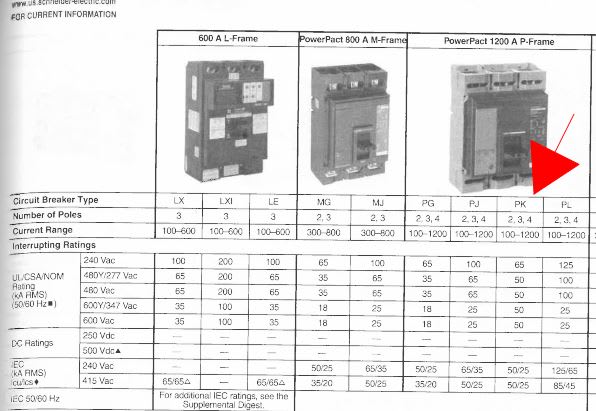

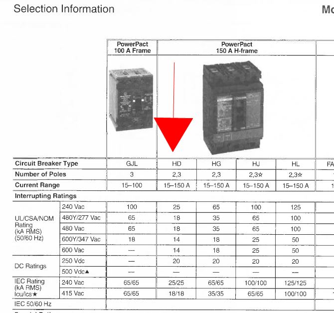

I want to follow up on Cuky2000 post....
"The rated short-time withstand current is the maximum current (expressed in kA rms) which the equipment shall be able to carry in the closed position for a specified time duration. The rated short-time withstand current is equal to the rated short circuit breaking current. Standard values for duration are 1 or 3 s."
In original post the short circuit symmetrical in the bus that this breaker is connected to is 26.55 kA. Asymmetrical is 35.931 kA. Per this data sheet out of the Sq D catalog the HD breaker is rated 18kA. Obviously this is too low for this application. But does that 18kA rating mean that this breaker will withstand 18kA for 1 to three seconds?
And this is the 1200 Amp Main and the 1200 Amp Feeder Breakers that are under the short circuit ratings. The feeder breakers are set to trip at 240 Amps.
The short circuit requirements for circuit breakers depends on the type of breaker and the voltage level - as well as the standards used.
For low voltage molded case breakers such as the Square D HD, it has no short circuit withstand rating at all. Only the 1/2 cycle momentary current is relevant. Molded case breakers must have an instantaneous trip, and the short circuit ratings are based solely on its ability to interrupt the 1/2 cycle momentary fault current. The short circuit rating listed is based on symmetrical amps, but the standards require short circuit testing at a maximum X/R ratio that varies depending on the breaker type, size and standard. From this test X/R ratio, you can derive the maximum asymmetrical current it was tested at. If the max asymmetrical current in your application exceeds this value, you essentially have to derate the breaker.
Low voltage power circuit breakers do have a 30 cycle withstand rating. High voltage breakers have both a 1/2 cycle withstand or close and latch rating plus an interrupting rating.
And there are differences in the ANSI and IEC ratings, test procedures and calculations. Many new low voltage breakers have dual ANSI and IEC ratings as you can see in your table.
