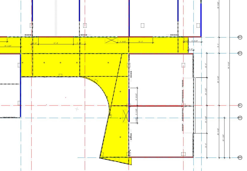

I am determining the lateral force distribution through a wood-framed apartment building. Hardly any of the shear walls align across the central corridor. Also, there is a geometric irregularity that I haven't seen discussed anywhere: the corridor curves.
So, my main question is really: Is it "OK" to ignore the portion of the corridor that curves for the purpose of determining the forces in the diaphragms, collectors that "matter", and the shear walls? I just don't know how to account for the curve and resulting layout of diaphragms and collectors.
When I say "matter", what I am suggesting is that the way I have subdivided my diaphragms results in a chunk or group of "sub-diaphragms" that are bounded on 3 sides by collectors and only have a shear wall on one side. Can I effectively remove this whole chunk to determine all of the resulting forces in the remaining diaphragms/collectors/walls? Does that make sense?
Wetransfer link to PDF showing floor plan, diaphragms, and basic diaphragm shears: [URL unfurl="true"]https://we.tl/t-4lSD4xm6uW[/url]
For wind, I'd approximate the curve with a large rectangle that covers most of the area - probably okay to clip the corners off a bit and ignore some of the gradual curves. That will give you a more conservative estimate of tributary loads going to the adjacent shear walls and collectors. Then, use the cantilevered diaphragm rules for that rectangle, which will have a comparable cantilever to the actual curved diaphragm.

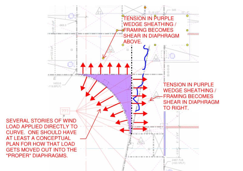

3) I feel that wind is actually more critical to this situation than seismic because wind will be applied directly to that curved wall face no matter where it ultimately gets resisted. See the sketch below. I feel that, at minimum, you should develop a conceptual plan for how wind applied to that curved face makes it's way over to your "real" diaphragms and shear walls.

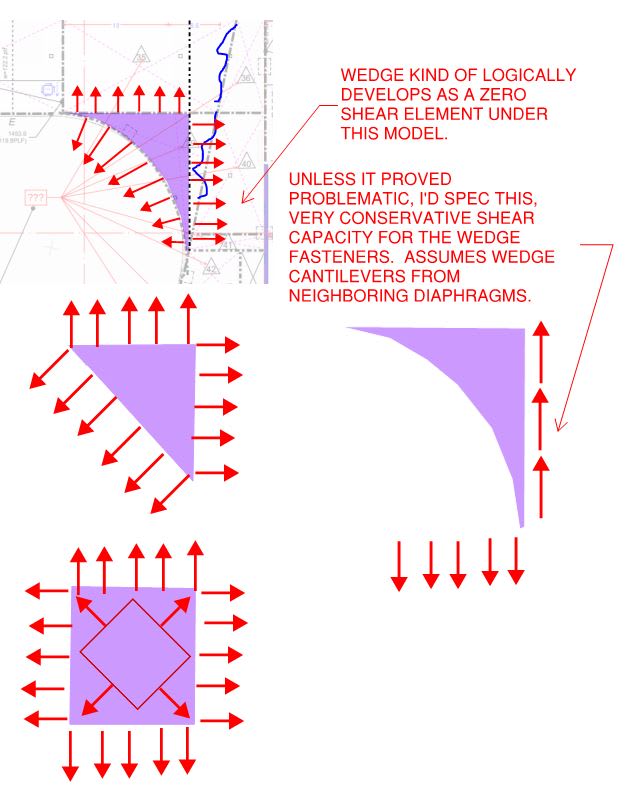

4) We normally consider our diaphragms as conceptual shear panels, carrying no axial stresses between boundary members. As shown below, I feel that the purple wedge will represent a departure in this respect. I feel it reasonable to assume that the purple wedge will transmit its load to the adjacent diaphragms via in plane tension in the deck and/or framing. As such, I think that it's important to recognize this mechanism and allow it to influence you detailing choices where prudent.
I'd certainly specify some diaphragm shear capacity for the wedge, maybe something like this. I would hope that it would amount to little more than just continuing the fastening pattern from the adjacent diaphragm panels through.

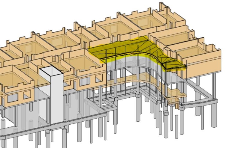

Thank you all for your input thus far! I do tend to get bogged down by trying to figure things out the "PhD" way. Bad habit. I should point out that there is not an exterior wall actually along the curved corridor. In the image below, the yellow highlighted portion is all open-air corridor. There will be steel columns and either steel or timber beams along the "free edge" of the curved portion.
More or less the same answer from me then. The yellow stuff will either need its own, independent lateral system or it will need to be made to ride along with the macro structure.
Are the yellow bits essentially canopy structure between sections of multi-story, enclosed building?
Any chance you could post an elevation of this area?
Koot, here is a 3D view focused on the curved portion. The elevation view is pretty wacky to look at. The highlighted area is the first level of wood framing above a PT concrete podium. There are 3 additional levels above this (2 floors + roof) all with matching layouts.
Thanks for the isometric. The situation is much clearer to me now. One thing to consider is that the columns supporting the curved area will derive their lateral stability from the diaphragm bits that they are attached to. It doesn't take much to get that job done but you do want a somewhat robust load path for the bracing function.
