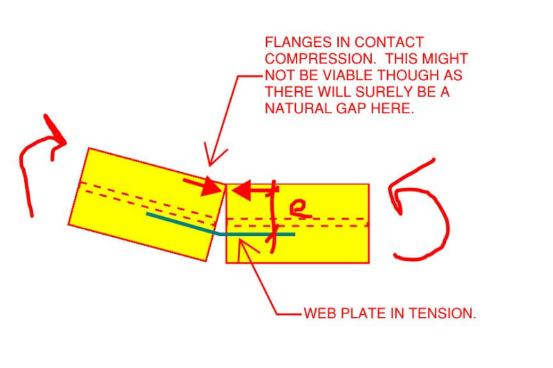

I would say so. I can think of one possible mechanism, shown below, but it relies on there not being a gap between the beams.
