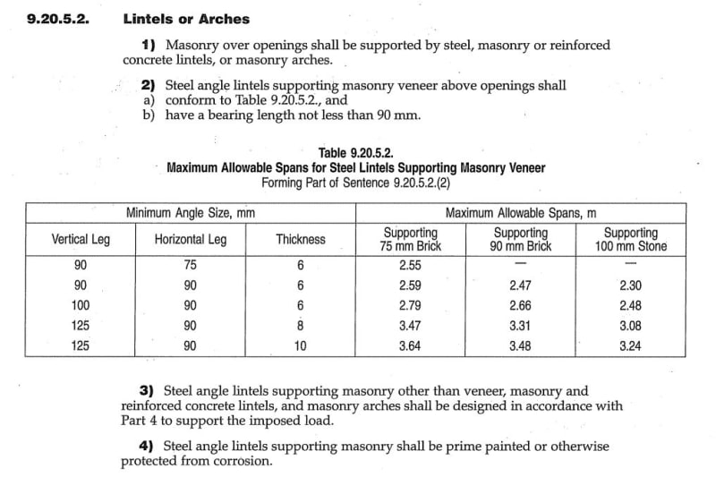

My strong suspicion is that nobody wants to touch lintel design for fear that, no matter what they do, a bunch of folks will think that it's wrong. The complexities abound:
1) Pretty much no way to load an angle that doesn't wind up biaxial.
2) The bearing reactions are not coincident with the shear center so you've got weird torsion in the member, and in the bearing stress checks.
3) Issues regarding how much load the angle is really taking with respect to brick arching, control joint locations etc.
4) One ought to consider twist in addition to vertical deflection.
When I moved back to Canada after starting my career in the US, I was pleasantly surprised to find that Canada's code has something for this. How they arrived at it, I don't know. And I don't much care. It seems fairly aggressive and I figure that, if zillions of buildings have used these lintels, my odds of success are good.

KootK... that's from Part 9 for houses and small buildings.
Well, yeah... that's where I got it from.

My experience with the Canadian code tables is mixed. The Code does not explicitly say it, but the tabulated lintels for masonry veneer assume that arching action can develop. So, if you have window openings in the masonry above the lintel, or small distances to the side of the opening beneath the lintel (no resistance to the thrust), then the tables should not be used ... but they are. These tables would also assume that a loose lintel supporting masonry veneer is considered to be laterally supported, thus simplifying the calculations significantly.
