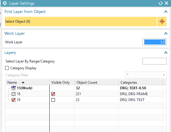

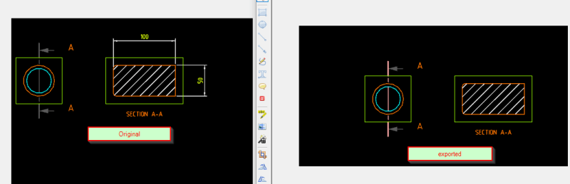

Hello Team,
I need your help. I am trying to copy the drawings from one UGPart to another UGmaster(drawing template). When I do Export->part, Only views and tables are getting copied, dimensions and Balloons are not copied. Work Layer is 15 and Drg,Frame is in layer 18(view)
Please help!
Check your layer settings, all layers with objects should be made SELECTABLE.
Jerry J.
UGV5-NX1884
Hi Jerry,
Layer 15 is work layer and Layer 18 is controlled for Template. Hence what ever is in Layer 18 is getting copied.
I moved Dims to Layer 18, then also Views and label copied.
Please advise
