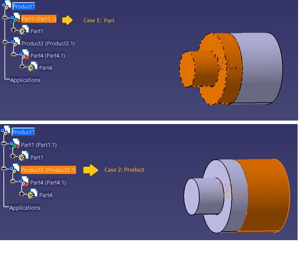

Hello
the scripts below works fine in the case 2 only and I don’t see why doesn't work in the case 1
-Case 1 : when selected object = part > any bodies copied in the new part !
-Case 2: when selected object = sub Product > the script copies and Pasts the Part bodies in a new part with the position
can somebody help?

I believe you need to make the copy after you set the second product active. The copy takes the axis system of the active product. This is a hard thing to wrap your head around but I can almost guarantee that origin (0,0,0 location) of the second product is different than the first one.
