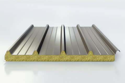

The roof is just a thin metal roof. And the only reason we want to coat all the metal part and make it fire rated to at least 2 hours is because there is adjacent building thrice higher less than a foot away. In case of fire, we won't want the flame to go up through the roof and scorching the neighbor's concrete walls, because they could sue my client big, like saying it has weaker their structural beams and columns and the entire building costing millions of dollars need to be replaced, etc.

In that case you are in category 3 and have a boundary condition. You may not need to protect the whole roof, but just the section adjacent to the boundary. I am not sure what your local standards are, but I would have thought they ought to stipulate a minimum stand-off.
With a thin deck you may struggle to achieve 2hrs with an intumescent coating. I suspect boarding the soffit with fire lining may be more realistic.

I can't find any youtube video of burning test of such 0.5mm metal roof. What temperature do you think it would melt and how many hours or minutes before it happened?
Can you successfully coat the bottom with fire coating material to create maybe 1 to 2 hour fire rating?
Or is it hopeless?
A metal roof will not achieve anywhere near a 1 hour fire rating.
You can get roof panels that are insulated and may achieve the fire rating you need.
One like the metal roof above was already installed in place years ago. If you would spray it with fire coating, what is the maximum rating it can get?
And how long and what temperature before a 0.5mm thin metal sheet melt?
Cant do this because the 0.5mm thin metal roof already installed years ago.
