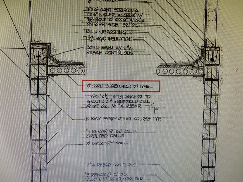

I am trying to track down a load table for a hollow core slab. Existing drawings (dated in 1984) call out: 6” core slab 57 type. Does anyone have any experience tracking down load tables for existing hollow core slabs?

Hopefully someone else can produce the load tables but my guess would be five, seven wire strands per plank unit.
