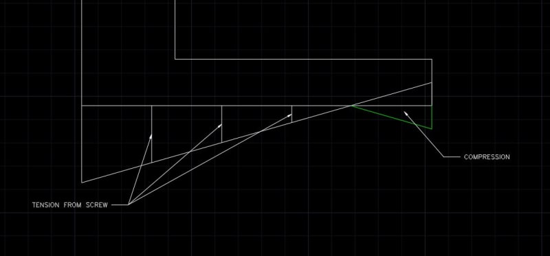

I'd start with a strain compatibility check. Develop a triangular bearing stress distribution between the two pieces of aluminum, using the maximum bearing stress permitted as the max value of the bearing stress. Then use some algebra and statics to determine tension loads in each screw that, when plotted, will fall on the same line as the compressive stress distribution. (Summation of moments will involve the tension forces from however many screws fall within the tension zone and the centroid of the bearing stress).
Your diagram says 1.5" typ for screw spacing, but they don't appear typical. The middle space appears larger than the others. Taking the neutral axis at the c.g. of the screws doesn't help because the force in the upper screw will exceed 335# pullout value.
Screw tension will vary linearly from minimum at the bottom to maximum at the top. Compression will occur in a small area at the bottom of the channel. Even then, the maximum tension exceeds the indicated pullout value.

phamENG - interesting approach with the strain compatibility. My concern with that would be that the bracket may not be rigid enough relative to the mullion assembly for that case to be true. Would there be perhaps a rule of thumb to goo with that assumption?

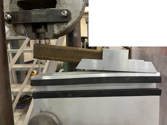

Thought you guys might like an update on this - we wanted to have further certainty so we decided to do a few quick tests to validate our assumptions. Perks of having a press at the office :) We were also able to modify the bracket to have the moment applied closer to center.
Our "pry" test had a max moment load about 3x higher than factored loads, which is reassuring. Not a perfect test but enough to get a pretty good feel of the behaviour.
jjl317 - we also did a test on shear in the direction of the screw chases. 4x 1/4" screws held up to almost 5,000 lb before we had to stop because the pressure plate was deforming too much. No sliding at all.
Thanks - I appreciate the follow-up - always good to see real performance vs analysis theory (and I have to admit I am jealous of the access to test easily)
