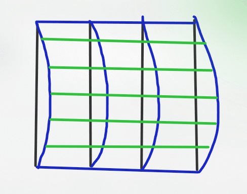

After I check the trainer's model again, I found that the purlins are not functioning as LTB restraints (i.e whole purlin just moved/slid) and the truss buckling/deformed shape is from start to end of truss, not purlin to purlin as the trainer claimed.
I guess for training they just focused on modeling aspects. too bad for me and sry to have disturbed you all. Anyway thanks for clearing my doubt.
Not sure how did you decide that ( the purlins are not functioning as LTB restraints (i.e whole purlin just moved/slid) and the truss buckling/deformed shape is from start to end of truss).. Will you pls explain?
Apparently the truss column connection is rigid and that is, compression force will develop at bottom chord portion around column. So you may need struts for bottom chord also..
human909 (Structural) has a valid point..(Additionally the truss does not seem to have appropriate LTB restraint for uplift.)..

Hi HTURKAK,
Sorry for the late reply. Now I don't have access to the model but I sketched this below to explain why I concluded Lcr is full span length.
This is the plan view.
Black color - original truss position
Blue Color - Deformed/Buckled shape. Lateral deflections of trusses are around 150-200mm but if I need plan bracing, it will reduce to a very minimum deflection <20mm.
Green Color - purlins.
