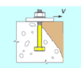

I was driving today and saw this streetlamp with damages in pedestal and baseplate:
[image][/image]
[image][/image]
What kind of failure mode is it exactly? How many days or weeks do you think before the lamp post falls down? It was just a random street. I have to make about 10 phone calls and many redtapes before it can reach the proper authority and I want to be exact in my description so they can do action.

I think you're seeing side-face blowout. Concrete breakout is likely next.
As for how long. Depends when the next big wind hits.
Notice the nut in the right side is nearer the bolt end. Do you think it just unscrewed slowly? or it's the original position of the nut?
Most likely it's the original position. The setting depth of anchor bolts and leveling the top of the foundation for those is typically not very precise, with leveling of the base plate relying on adjustment of the leveling nuts. They do tend to tighten them up well, otherwise the the pole wobbles badly.
Could be bad installation, insufficient edge distance, a gentle nudge from a vehicle or a combination of all of the above.
There’s no way to calculate how long it will last.
Any change the whole assembly got a solid nudge & deflected and they tried to re-plumb it using the bolts?
That could be a shear failure and not a tensile failure too.

It looks to me that the foundation was out of plumb before. The base plate seems to have been adjusted relative to the foundation so it's level, even though the foundation is crooked.
Apparently the anchor bolt at right side mislocated and bended to the right to fit the hole of baseplate so the nut does not match with the base plate..
Another point , the pedestal is out of plumb as BridgeSmith (Structural) pointed out..
We just see two of the anchor bolts and it is hard to foresee the probable failure mode.

We are looking at the near side (NS) of the pedestal, the Left Hand (original) anchor bolt is significantly further from its edge-of-concrete than the Right Hand (RH) Near Side anchor bolt. The RH-NS anchor bolt was also drilled in place, cast in place crooked and slanting significantly, so its bolt can only carry its load at the tip of one bolt corner, not all around the bolt hole as designed. This puts a point-load stress on the anchor plate.
BUT! The whole plate is twisted about its centerline!
The Far Side Right Hand anchor bolt is way too close to the RH concrete edge, violating all code requirements, The Far Side LH anchor bolt is pushed too close to the Far Side concrete edge as well.
A photo of the Far Side concrete should how even more concrete cracking and rebar exposure to rust.
