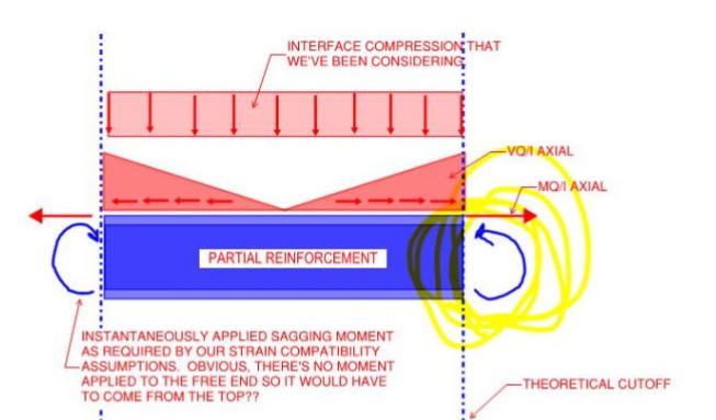

3) In that other thread that I referenced, we arrived at a fairly robust free body diagram of the the reinforcing piece considered there. The same model should apply quite well to the inner tube of your case. Note, in particular, that that composite action involves five actions imposed upon the reinforcing piece:
i) Distributed horizontal shear, VQ/I.
ii) A distributed, transverse load applied upon the reinforcing by the main member through the interface connection.
iii) A concentrated, transverse load applied upon the reinforcing by the main member at the the ends of the reinforcing and opposing [ii].
iv) Where the reinforcing does not extend the full length, a concentrated horizontal shear, MQ/I.
v) Where the reinforcing does not extend the full length, a concentrated moment at the ends of the reinforcing.

C) For one wind direction, [ii] will be resolved by the main member pushing against the reinforcing and creating no axial demand in the fasteners (only the shear). For the other wind direction [ii] needs to be resolved by the member pulling away from the reinforcing and creating a tension demand in the fasteners which should be combined with the VQ/I shear demand.
D) Per AaronMcD, it's pretty common to assume that the two members are not composite owing to uncertainties regarding connection slip etc. At least that's the case when the benefit to the moment of inertia is quite modest as I discussed in [#2]. So design the fasteners for composite behavior but consider ignoring the composite action for the macroscopic design of the composite member.
An important observation related to the free body diagram above: the composite behavior is a result of more than just the horizontal shear, VQ/I action. Rather, it's two primary actions:
1) Horizontal shear, VQ/I and;
2) The transverse load acting across the member interface.
The greater the improvement to the composite moment of inertia, the larger the role of [VQ/I], relatively speaking; the smaller the improvement to the composite moment of inertia, the lager the role of the transverse load acting across the interface. In the extreme, there is no VQ/I and I_comp = I_main + I_reinf.
