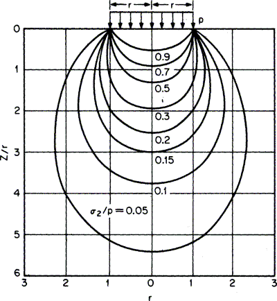

milkshakelake, I too had the same concept that if they are in the same leve/ elevation at the underside of footing then the minimum distance shouldn't really matter, however I went through the above-posted forum and find something about overlapping stress of the soil when they are closely placed. So, how do you consider that and your opinion on it please.

The soil pressure under a footing is a "bulb":
Although pressure deceases with depth, soil pressure bulbs can overlap, overloading soil.
A simplified, traditional way to estimate if overlapping pressure creates a problem is shown below:
Here is a basic example for the OP's 3.90m x 3.45m footing.
1) Assume a depth of 2m.
2) At that depth, soil pressure is estimated to be:
Service Load / (3.90m + 1m + 1 m) x (3.45m + 1 m + 1m).​
3) Do the same for the second footing. If the pressure areas overlap, add the two pressures.
4) Where the pressure areas overlap, the total of the two values should be < allowable.
