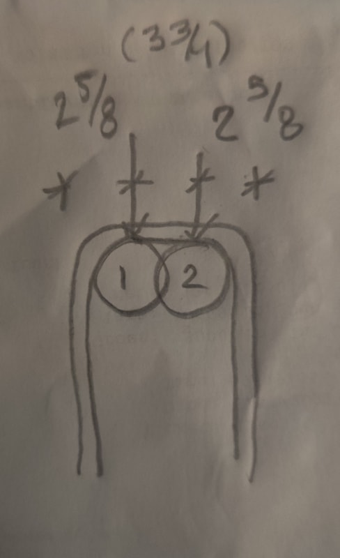

I understand the minimum diameter (5 1/4" in this case) pin for the corner bends, I just don't understand the 12d minimum width across.
I'm conceptually struggling with the idea that the bend from one corner is somehow continuing along the "belly", or short piece, on the end past the radii. For instance, if I wanted an interior width of 9" (I do!) there'd be ~3 3/4" of straight bar to play with there? Bend one corner at pin position 1, scooch it over to pin position two and bend again?

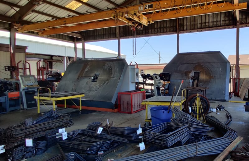

Here's a couple of their monster bending tables
Yep. Looks like they may have done it a time or two before today.

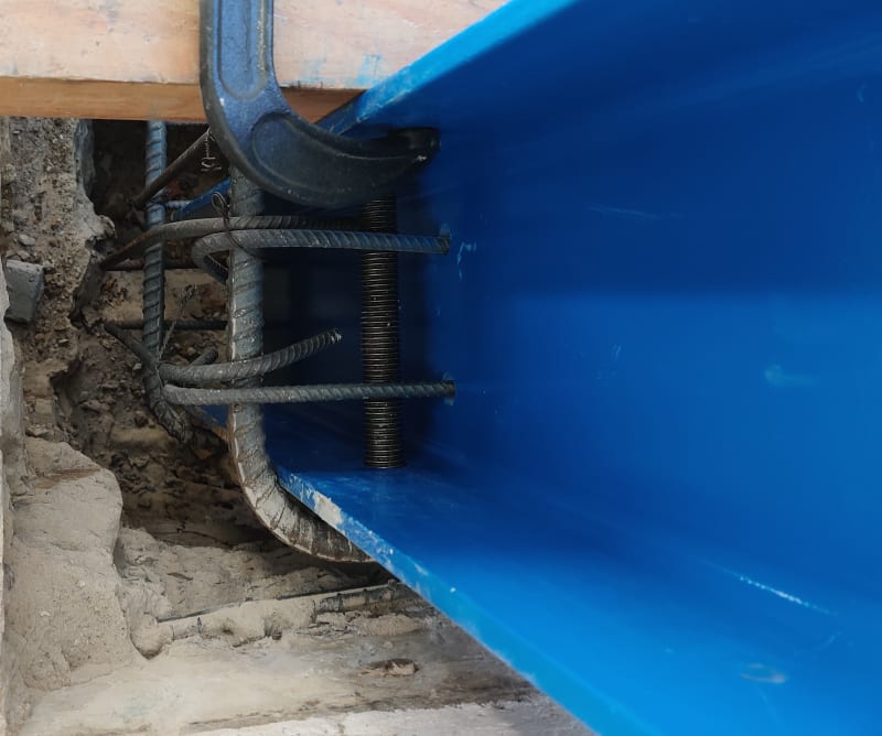

The weird thing is last october they delivered the pair in the first pic, with two 90 degree corners and ~9" spread. Either they cheated on the corner diameter that time (I didn't check, and those pieces are buried like Jimmy Hoffa now), or they found a trick, or something.

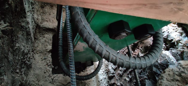

That looks a lot like a single 180 to me.
Just think of it as preserving your lungs for posterity.
The last pic is a single 180, hence the Michaelangelo work at the footing...
The first pic is twin 90s. It's also the same bar wrapped snugly around the blue column.

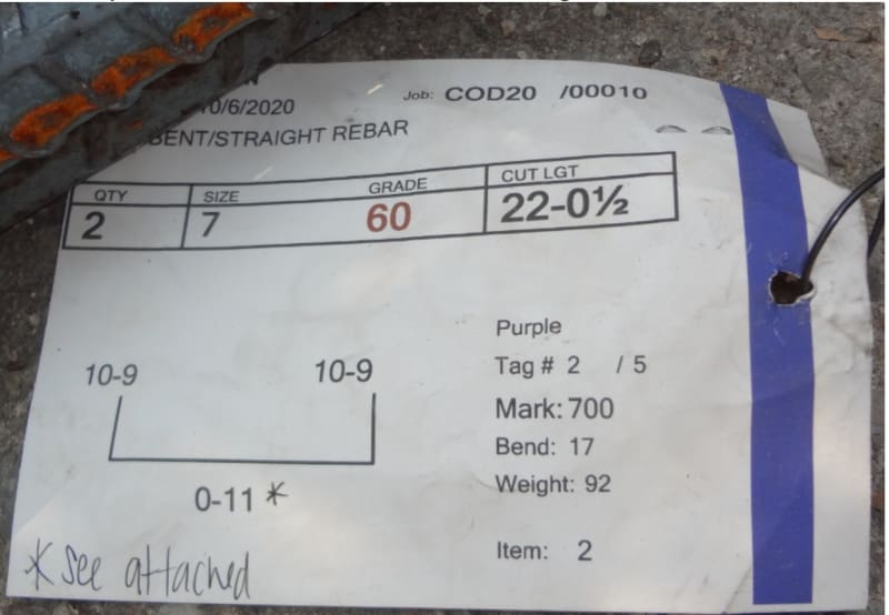

Here's the tag from the delivery last October, for S's and G's. The 11" is outside-to-outside, the manager at the fabricator always says the true bar diameter is 1/8" greater than nominal diameter.
