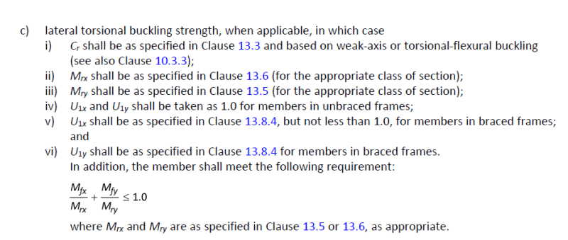

Hi Everyone.
I recently started designing with the CISC and I am loving the process of understanding a new code.
I have a small question regarding the check of beam columns for combined axial and bending.
In clause 13.8.2, in the third check for lateral torsional buckling strength, the code specifies that Cr should be based on the weak axis. In the beam i am designing, we provide enough lateral restraints in the weak axis that the KxLx/Rx is actually the one dominating the design and the buckling should be about the "strong axis".
Is there a reason for the code to always ask about the weak axis? does it mean the axis for which buckling is dominant? and how can i combine that with the lateral torsional buckling?
Thank you for your input.
