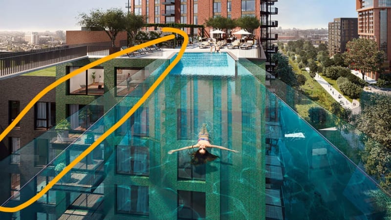

As much as this image looks like CGI, its not. Its just opened in London and appears to be made of 200mm thick acrylic. The span is about 14m and it consists of a 200mm thick acrylic slab spanning between upstand beams. These beams are 200mm thick acrylic x 3.3m high!
I’m still unsure as to why the compression zone of these incredibly slender upstand acrylic beams does not LTB itself into oblivion! I understand the concept of U-frame action in chunky steel bridges, but this seems to defy all understanding I have of structural behavior! Can anyone shed some light on this? Its very impressive!
Ps - for those wondering about redundancy, as I was, there are 2 No. steel cables beneath the slab..
Does the picture show a flange on the top? Which isn't shown in the cross section?

It looks like there are top flanges for the upstand beams, making these upstand beams essentially angles:
That's probably it right there. Better than angles really... an upside down hat sections.
At the proportions involved, I suspect that this thing probably isn't even working all that hard. I'm surprised that it doesn't have guardrails on that flange though. That's a lot of faith to potentially place in drunks, teenagers, drunk teenagers.
Craig, I thought that too. But that line we see is the water level below the top of the ‘beam’.
I don’t think there’s any angle/top flange from what I’ve seen. Check out the youtube videos, there’s definitely no top flange.
I can only imagine the consequences of this going wrong..
You're right, no flange. What we're seeing in the photos is really freeboard. That explains the absence of a guard rail too.
