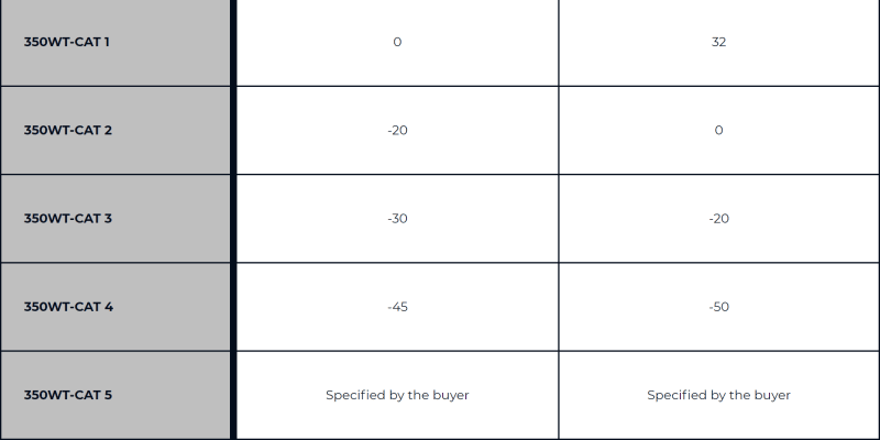

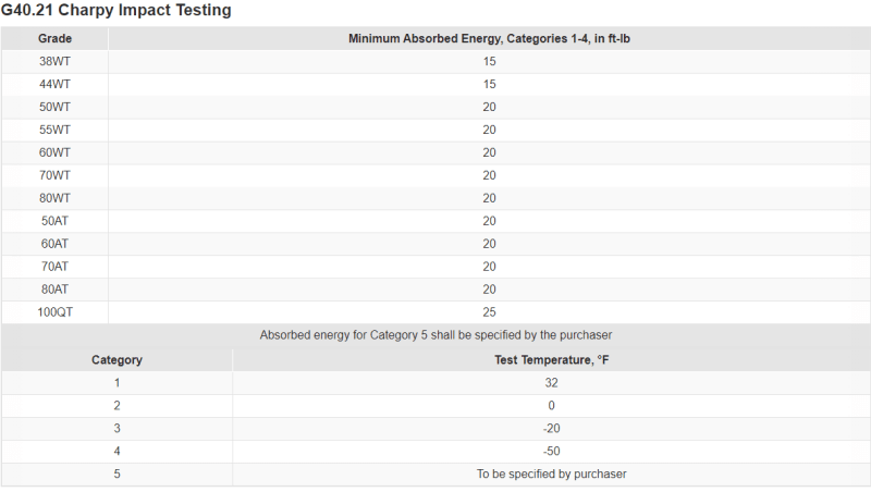

For northern projects, I normally spec G40.21 350 WT which is a low temperature Canadian steel and they have 5 different categories...for northern projects, I usually do a CAT3, unless there are special concerns. I don't recall ever using a CAT5.
