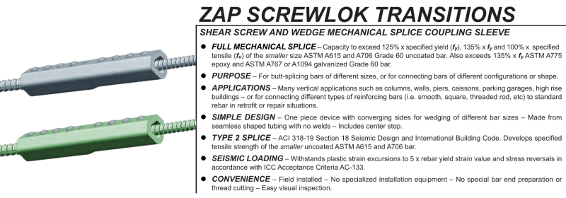

BarSplice's ZAP SCREWLOK TRANSIITONS looks promising.
They state they are for "different sizes, or for connecting different configurations or shape".
Those might be really handy in my line of work. If you go that route / find something else that fits the bill would you mind reporting back here with how it worked / approx cost?
I shall indeed.
==> EDIT: I called BarSplice and spoke to engineering/technical and they have used ZAP SCREWLOK with old square rebar to new round, you just have to up the size of square by 1 size, so if #4-square to #4-round you would use #5/#4 transition ZAP SCREWLOK. However, no testing/approval/ESR for such use with square section.
