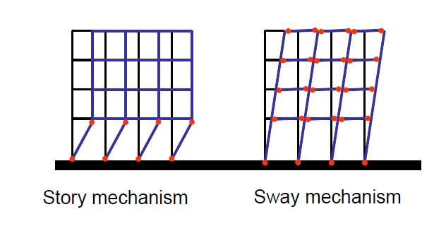

Hello Dear Engineers,
How do you calculate weak story??
Definition: A weak storey is one in which the storey strength is less than 80
percent of that in the storey above. The storey strength is the
total strength of all seismic-resisting elements sharing the storey
shear for the direction under consideration.
What does the shear strength mean here? Is it sectional nominal shear capacity (2sqrt(f'c)bd) or shear produced to balance the probable moment at column ends (i.e, (Mpr1+Mpr2)/story height)?
Thanks.
