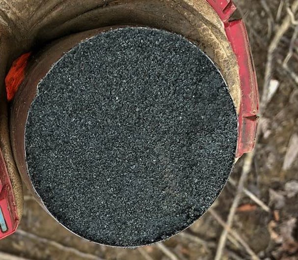

This is true for most situations but can be achieved for a manageable cost in fine grained sands to silt material, common in tailings using a specialized piston sampler to get undisturbed tubes, the name of which escapes me currently.
GEG - I have heard that before, and my company even use similar sampling methods, however I think they are just less disturbed than other sampling methods. Not suitable for doing a triaxial test on, IMO.
The name is a GUS sampler.
