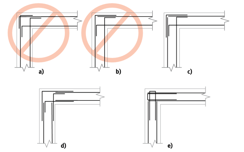

Below is the math that I use to figure out the bar dimensions......... No one has ever back-checked it; so feel free to let me know if I screwed up the trig. :)
Check out the concrete international article "Corner detail for wall horizontal bars" Also I would keep it simple if you try to get fancy the contractor will misplace the bars
No idea why 'a)' is no good... and I would never use 'd)' or 'e)'.
Dik - 'd' and 'e' are the CRSI recommended ones lol
'a' is bad for constructability because you have the long hooked bars, which I think can be difficult to align and get tied up. (or you have to do a series of laps immediately after the corner)
On thinner walls, I use 'd' and I like 'e' on thicker walls. The rodbusters can assemble the cage and then just slide in the U-Bars at the corners. You need enough wall thickness to make the 180 bend in the bar though.
Agreed, its all about constructability. Imagine threading the corner bars on a huge mat with #8 bars.
I've not found it to be a constructability issue... they are easy to place and can be tied to the horizontal bars in the opposite wall. What you want to avoid is having bars with two hooked ends, then there is not adjustment for slightly off forms. I think it's bad terminating bars at corners because if any shrinkage, due to the restaint, it is likely to initiate a crack. Just my $.02...
The efficiency ratings in GC Hopi's post are based on testing by Nilsson and others. The double U bars are simple to place. The corner bars are belt and braces in opening corners.
Hokie66, you beat me to it...good work.

To answer the OP too: I make sure the rebar is developed across the critical crack location, with usually enough to tie it around the horizontals for placement. Typically I specify 12” on the bent leg overlapping the horizontal bars. This isn’t a fail safe but works in most cases. I just check it quick before it gets issued to make sure the typical detail works.
The MacGregor text also repeats what Hopi posted.
U-bars are easy (in relative terms) and reduce the number of bar planes vs individual hooked bars. However, unlike what e) shows, the "main" wall bars should not, and do not need to extend into the corner - the horiz bar lap should be away from the joint.
For water retaining boxes, the diagonal bar not only minimizes cracking at opening corners but also helps with the combined tension-shear problem, where the "bursting" tension is seriously derating your one-way shear capacity.
