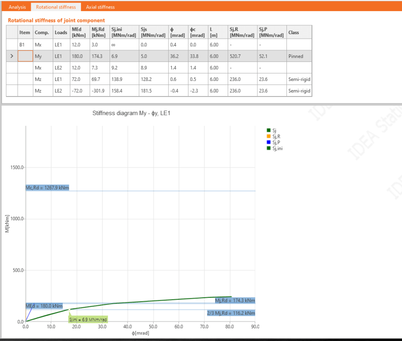

Hi!
I have calculated a moment connection by hand. It must resist a moment of 210 kN*m. Everything works. However, when checking it in Idea-StatiCa, the connection is modeled as pinned. Would it still be legit to consider this as a moment connection? The classification of pinned vs semi-rigid vs rigid is based on Eurocode.
It's possible that the program is looking only at force rotation curves to determine moment vs pinned connections. Since you're connecting to a torsionally weak moment connection, that deformation curve is going to be pretty flexible.
I know that this connection is sufficiently resistant (it was also verified that the connection was sufficiently resistant in Idea-StatiCa). However from I understand, these are the consequences:
1) Since it is not very stiff, it will deform alot in rotation.
2) Thus, the issue will be that the infinite stiffness assumption of the moment connection in my Advande Design America model for the member calculation will be different from reality.
3) Hence, the forces will be spread differently in reality vs in my model.
Correct on all three. You did make sure the top flange bolts are all slip-critical in IdeaStatica, correct?
Yes they are slip-critical both in the model and in reality.

This is an evaluation of an existing structure, so I was trying to see if bracings would be required due to the flexiblity in the "moment connection". However I can't modify the connection.
My program does not consider torsional warping. However in this case, I don't see where there could be torsion in the wide flange beam. The HSS is in torsion, but the wide flange beam is in bending.

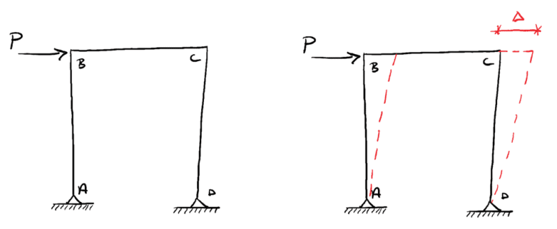

However, I am trying to make sure that the lateral stability of the moment frame is adequate, since it relies solely on those moment connections.

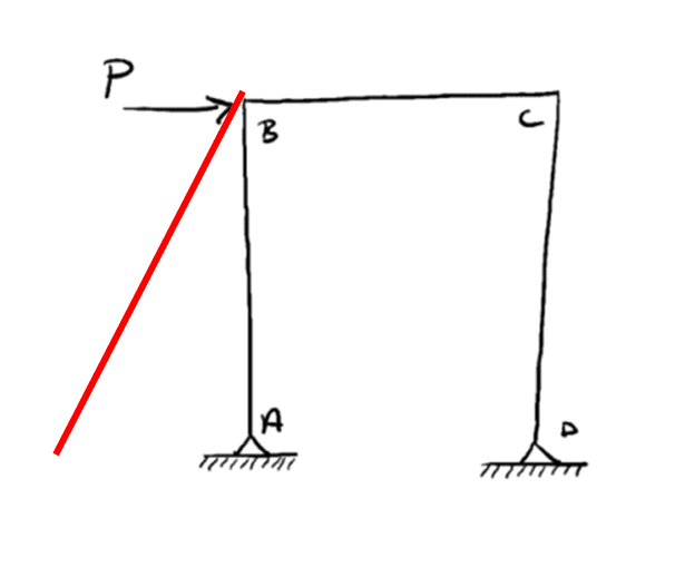

Or if it requires a bracing like this:
Ahhh, that makes more sense to me now. I mis-interpreted the moment that was being transferred to the WF beam. Your frame analysis should be fine.

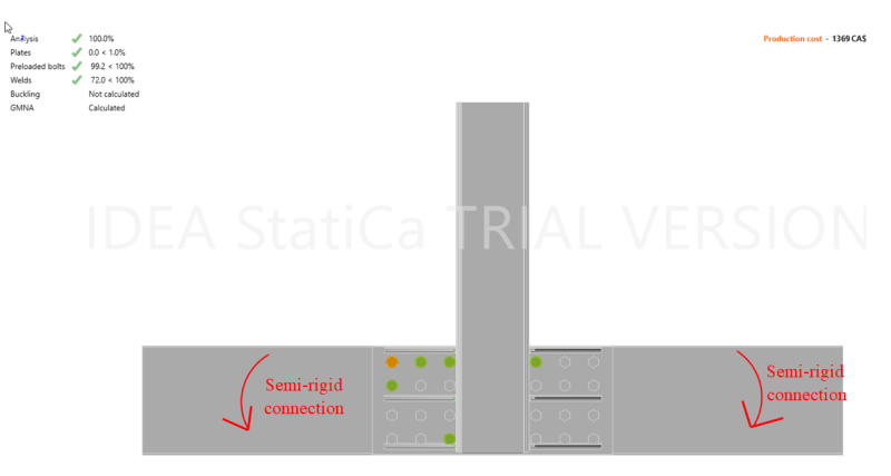

Finally, here is my rationale that bring me to think that a bracing is not required:
- There is a bracing in K on the other side of the frame:
2021-09-21_12_39_04-Advance_Design_America_-_190425-NLH-NEW-SSTR-R109_TEST4.vd1_ukhkro.png

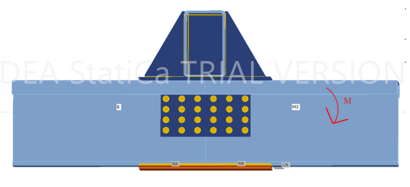

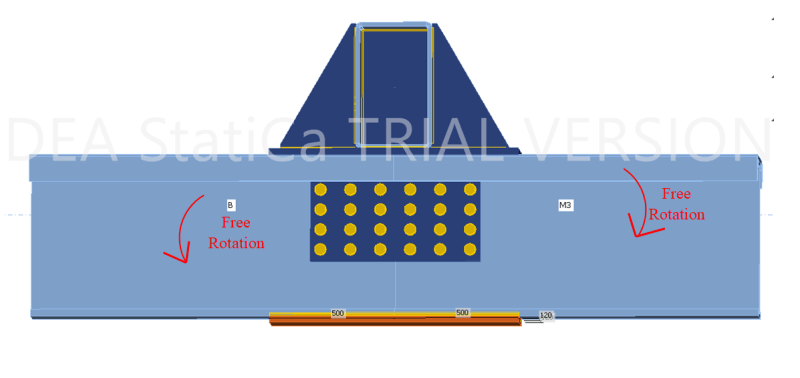

- By putting the connection as pinned (free rotation) in the direction in picture 1, it remains that the connection, which is semi-rigid in the direction shown in picture 2 according to Idea-Statica, is sufficiently strong to hold the lateral load so that the bracing in K can contribute on the other side of the frame.
Picture 1 (view from the front):
Picture 2 (view from the top):
- The beams are able to resist having pinned ends in bending around weak axis.

It looks to me like you have done everything you can to make it as rigid as possible.
I'm not sure it's a "traditional" moment connection like we see with Beam to Columns. The classification that we see in AISC (or other codes) based on rigidity is most likely to apply best to beam / column moment connections.
The offset of the Tube from the wide flange makes this categorization a little trickier. I definitely wouldn't call it "pinned". So, semi-rigid might be the best way to term it.
