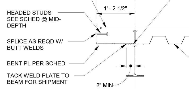

Can a composite / rigid diaphragm be designed as unreinforced beam. As the diaphragm is a beam with significant depth (150' in my case) , can I just check for cracking stress and avoid adding any rebar or chord members ? Mc/I is significantly less than cracking strength of concrete
I don't love it, reduced ductility and all. How confident are you that your concrete deck will have no shrinkage cracks in it when it comes time for it to resist it's seismic flexural demand? In a sense, the beams that form your diaphragm chords kind of will be a form of diaphragm reinforcement.
Samwise - is this the same building you've been posting about with steel deck? If so, then I'd advise you to detail it so your concrete is NOT the diaphragm. I'd use the steel deck as the diaphragm - the concrete on top just stiffens it and drastically increases its capacity (as a diaphragm). SDI diaphragm design manual and the various deck suppliers have special tables for diaphragm strength when their deck is filled with concrete.

I do not practice in CA. I am in the intermountain region. I am going to still have the angle to behave like a chord member. And if I get any resistance from the diaphragm to act as chord, that just provides me with multiple load paths
Keep in mind you have to have a connection between the diaphragm and the collectors, VLFRS, etc. In steel framing with concrete fill, there is rarely a suitable connection between the the concrete and the steel unless you're doing full composite construction. The bond between composite deck and the concrete isn't enough. You'd need welded studs between beams and your concrete to use the concrete as a diaphragm. Without it, it's just a filler to stiffen the steel deck diaphragm.
Certainly, I agree with phamENG that it's s stiffened steel deck diaphragm unless there is a direct, and convincing, connection between the concrete and the boundary members. Normally that's going to be headed welded studs. Maybe DBA if your slab was a foot thick or it tied into the sides of your beams etc.

Samwise - how are you connecting the slab to the collectors?
The deck/ composite slab is connected to the collectors using puddle welds. Given that its a composite beam framing, I also added a note saying that headed studs in construction may be substituted for puddle welds.
Ah, full composite. Got it. If you already mentioned that the beams were also composite, I apologize - I only picked up that the deck was composite. In that case, you can use the concrete as the diaphragm. But the puddle welds do nothing for you. If the concrete is the diaphragm, ALL load has to go into the concrete and then out again through the studs along the beams/collectors.
If there is a way to mix the two, I imagine it would be unnecessarily complex for the vast majority of practical design situations.
phamENG, I am exactly following the load path that you quoted. Diaphragm transfers lateral load per unit length into the collectors/braced members through additional studs that I added in the beams. For the chord forces, I would have liked to simply use the edge angle and be done with it. But given that the edge angle is discontinuous, I was trying to use the concrete diaphragm to take that chord force through a rebar or just the existing mesh I have. I am just not convinced that the diaphragm can be treated as an unreinforced deep beam and just check for cracking.
Correct. If the concrete is going to be a diaphragm, it should be detailed in accordance with ACI 318. I practice on the east coast and I'm not overly familiar with the Intermountain Region - but I take it you are in a relatively high seismic area. That's going to mean plain concrete isn't allowed. You'd have to go with reinforcing and all of the prescriptive ductility requirements. That could very well mean your concrete slab has to get thicker to accommodate everything.
If the loads work, I recommend keeping it in the steel. Forces go into your deck and then get transferred to the collectors (beams, spliced angles, whatever you want to use) through the puddle welds. The concrete just stiffens the diaphragm, which increases its capacity and in most instances allows you to assume a rigid diaphragm for global analysis. If you can't assume (irregularities, etc.), then the calculations usually work out for it to be rigid or very close to the rigid end of 'semi-rigid'.
Your detail indicates that the edge angle is continuous with butt-welded splices. That said, I don't see an issue with using the slab reinforcement as a redundant chord/collector element along with the beam line and edge angle. Doing so makes me *feel* better from a strain compatibility perspective. In other words, there are no breaks in the angle, beam line or slab reinforcement where the axial load has to "jump" from one element to another - just multiple load paths that can strain uniformly.
So I am trying to put all of this together. On the roof, yes I will have a continuous angle to behave as a chord member.
However on the slab, I can't have the a continuous angle . So I was going to trim the angle at the column. The angle goes from a HSS 5x5x3/8" to an HSS5x3x3/8".
