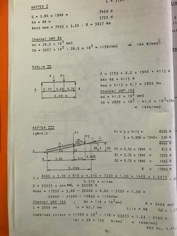

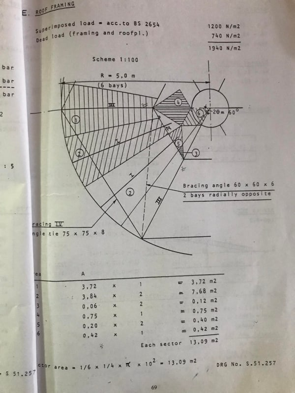

I would like to have some advice on design of main rafter and compression ring for storage tank.
I have attached a calculation note and would like to know if the principle is okay.

-The roof plan shows one purlin ring while the rafter has four point loads..The loads are only point loads but the rafter subject to continuous trapezoidal loading ..
-The rafter subject to bending (which will govern for the design ) and shear forces while you have calculated only axial load.
-You did not provide bracing..
-The compression ring could be calculated using ROARK method. In general, circular angle ( made up of plates ) is used.
You may prefer to provide more details to get more specific replies.
actually the rafter is subjected to trapezoidal load and i converted it to point load.
i want to know if am right
at point A there will be a horizontal force, D and resultant force, R.
at point B only horizontal force, C and NO resultant force, R
DOES THE FORCE 52200N ACTING ON COMPRESSION RING CORRECT
"actually the rafter is subjected to trapezoidal load and i converted it to point load."
Where does this load come from? How will you "convert it into a point load" in practice? You will need an additional beam above the rafter, connected only to those discrete points, to provide load transfer from trapezoidal into point loads.

On a 10m diameter tank, we'd normally use either a column-supported roof with single column and radial rafters, or a self-supported cone or umbrella roof (with no structure).
With the roof analysis shown, unbalanced loading becomes a problem to analyze.
I don't know if I buy what you are doing because the forces at "A" is represented by a vertical and horizontal force. In reality, I would think (depending on how it is attached) there would be rotational restraint as well. (Which would [I think] impact forces.)
I would second that it is not the most economical option to use multiple layers of rafters for this size of tank. Why not just have rafters extending radially from a halo at the center of the tank with a single column? The current configuration just seems to add extra design time, construction cost, and maintenance issues.
I agree with LAZAR90's analysis. This setup is similar to a ladder on the wall of a house. No vertical load at the top of the rafter.
I checked by converting the calculated and given forces to the components parralell to and perpendicular to the longitudinal axis of the rafter. the axial forces sum to zero. conclusion - C is the resultant at the top of the rafter.
