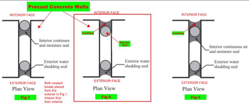

Hello!
I have thought joint detail should be Fig-2.
But, when I read about the concept of two-stage joint, I realized Fig-i was correct.
And then, when interior face is exposed, don't we need to use Fig-3?
Personally, I have never used Fig-3 detail.
Thanks for your time!

I wouldn't use fig. 3 unless there is a cosmetic requirement or there's moisture (actual water, not just vapor...) on the inside of the wall.
Generally, Fig-1 does not sense because backer rod will be exposed to the interior space.
(Unless another interior wall is standing nearby, Fig-1 cannot be applicable.)
Fig-3 looks expensive to implement.
What about Fig-2? What is wrong with Fig-2?
I think Fig-2 detail is generally used. Wrong?

I have done very detailed variations of these types of details frequently. This is specialist weathertightness design, if you are not assuring for weathertightness, you are best to let the architect/envelope consultant take the reigns.
Fig1, is impossible to achieve. even skilled caulking applicators would make a mess of this. its too far to reach your nozzle, tool, the backer rod can too easily be pushed out the far side.
Fig3 is someones "good idea", going overkill, which is actually a bad idea. how does moisture drain from between the two seals on either side of the single backer rod if it finds a way in? yes, moisture should be assumed to always find a way in. also, same issues of installation as Fig1
Fig 2 is totally appropriate. the only reason people deviate from Fig 2, is they wonder, how will the seals be applied on the interior side when they cannot be accessed at brackets, slabs, etc? the secret is to use a short run of expanding foam tape like Emseal or sika600 to form the barrier, slide it in by hand, and butt your caulking joint into that. its only acting as an air seal, and does not need to be perfectly weathertight, as the airspace between the two seals needs be formed as a drained and ventilated cavity.
similar to this last detail posted by JohnRwals. every cavity need drain, dry, and be broken up regularly. every level is best, so if there is a leak, it doesnt originate 8 floors up and manifest 30 metres to the west and leave some poor sod scratching his head about how its getting in

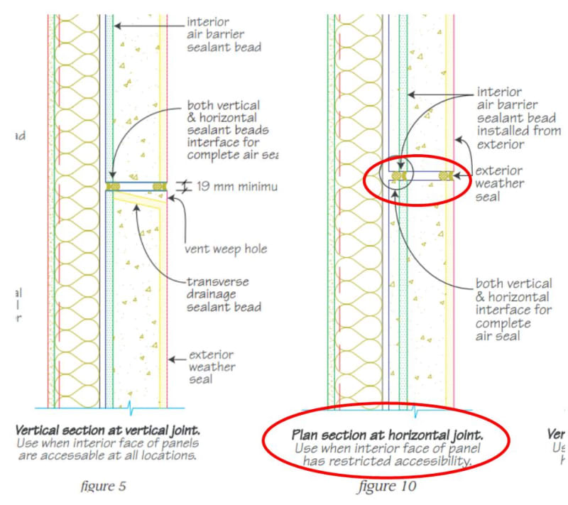

I am adding another detail from Canadian Precast Concrete (CPCA) precast joint detail brochure.
This description seems to be more reasonable..."accessiblity"
Is there really difference between Fig-1 and Fig-2 except visual effect or field application difficulty?
JWR
This problem could happen everywhere.
For instance, what can you do when you cannot access joint due to the adjacent column?
Can you skip this interior joint caulking?
Or, do you have to follow Fig-1 detail?
Though subcontractor omits this joint, you may not know that until serious leaking issue shows up.
This means both Fig-1 and Fig-2 details should be applied...
What do you think?

at the joint you have circled, use a foam seal like sika600 or emseal.
this may need to be placed on the panel before it is lifted into place.
note, the important details are not these 2d details you are showing, but what happens at splices, joints and ends. thats where the leaks will happen
