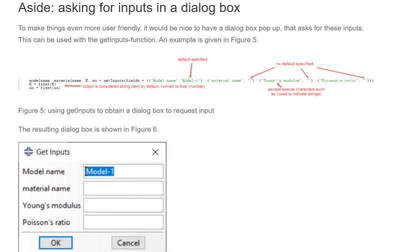

Try changing this command to waitForCompletion()
If the second problem still persists, check the .dat, .msg and .sta files for more specific error messages. Also, make sure that the generated input file is correct.
A recent article on Simuleon's blog ("Abaqus python scripting: how difficult is it?") might be interesting for you. Automatic submission of subsequent jobs is also discussed there.

I'll give it a try.
I liked that blog post you referred me to. Love the getInputs command. I've been trying to figure out how to get Abaqus to prompt me for inputs.
