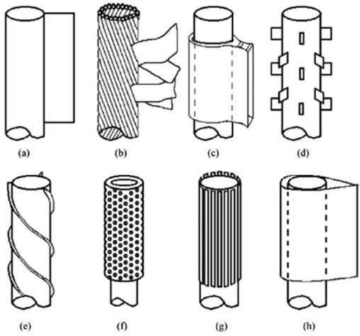

The complaints and description sound like a vortex shedding issue under low to moderate winds causing excessive vibration. This happens when the excitation from the vortices is close in frequency to the natural frequency of the pole.
If this is the issue, you can either take measures to change the natural frequency of the pole (add mass, increase stiffness, add dampers, etc.); or you can add helical strakes (or something similar) to the outside of the pole to add turbulence to the airflow around the pole so that vortices won't form.

@dauwerda thanks this is a very helpful comment. When you say to add mass, do you mean adding another thicker pipe around the existing and through bolting/welding? The helical stake sounds interesting but I can’t visualise this as I haven’t seen this done before. Would these be connected to the chimney as well? I also fully agree with the client taking a video.

There are a few ways to add mass. The simplest would be to plug the bottom of the pipe and fill it with sand or grout. If sand is used you would probably want to use a screen at the bottom so that moisture could find its way out and seal the top to prevent moisture from getting in. You could also use a pipe with a thicker side wall X-Strong or XX-strong. A standard practice for large static masts in substations (think 50 to 100 feet tall) is to hang a large chain (1" diameter links) inside the mast that is 5-10% the weight of the mast (chain is surrounded in flexible hose to prevent clanging inside mast). This adds weight and acts as an internal damper. For something this small, I don't know what type of dampers would be available or practical.
Here is am image showing different attachments that have been used to prevent vortex shedding:
