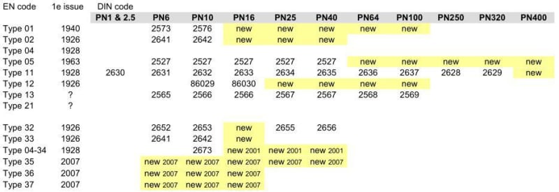

-In DIN period (from 1928 to 2007) only the PN10 range of type 04-34 consist,
-After 2001 (harmonization DIN to EuroNorm) PN16 to PN40 are added,
-Some of the dimensions of the welding neck flange are taken over,
-There are no re-calculations made on the new type 04-34.
-There is only one firm in Europe who is manufactured this type (I did sent the report to them and hope on response).

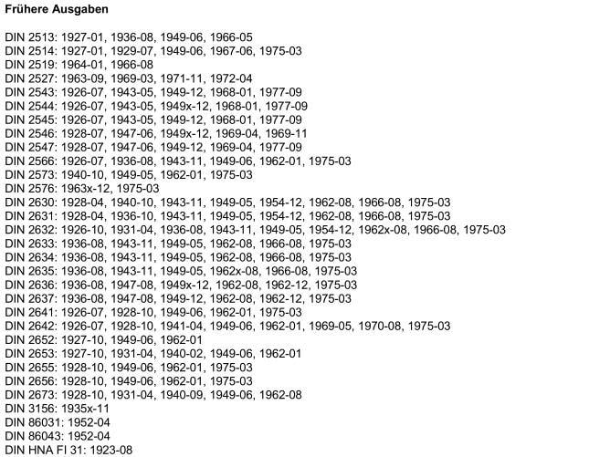

Flange data in historical perspective.
Carl Sagam once said “you have to know the past to understand the present”. In other words, if you can link facts, then the answer is already there.
Taken from the introduction alinea in BS-EN 1092-1 (2007),
Major changes against edition 2001:
-flanges PN160, PN250, PN320 and PN400 have been introduced;
-further collar types have been introduced;
-materials have been updated.
Re-calculation acc EN 1591-1 for,
-type 11, 05, 01, 02-32, 02-33;
-type 35, 36, 37;
-type 21, 04-34 have not been re-calculated acc EN 1591-1;
-type 12, 13 have been adjusted to the results for type 11.
Before year 2001 all the type numbers where DIN codes.
Just more original data,
Some time ago I did a little research of the weights of ASME flanges in comparison with DIN flanges. In most cases the ASME flanges are heavier. There was an article (can't find it anymore) on internet about the 2nd war period in Germany about shortage of raw materials. They needed it for the war industry. In the period 1936 – 1943 there were some changes in the DIN codes. I can not verify the decrease in weights in that period, mine oldest source is the “Deutscher flanschenkatalog” from 1967. It could be a minor explanation for the differences in weights. On the other hand, I know that the CODES are normative.

How to reduce the number of flanges in the EN 1092-1?
ASME B16.9 9 types of flange components
EN1092-1 16 types of flange components
I have split the types by material and pressure range,
Proposal;
Type 33 to combine with type 37
Type 35M to combine with type 35 ISO
Type 02M to combine with type 04
Type 04-34 to re-design
The committee CEN/TC 74 could have reduced the number of types with a little more imagination, this benefits the right choice and stock management in the business community. Because there is a tendency in process technology to work with increasingly higher temperatures so that chemical processes run better, the welding neck is now the only candidate for this. It is possible that a better flange concept will be developed in the near future that offers more advantages compared to the welding neck flange. Maybe this will be the new type 15 or type 22? A more balanced EN 1092-1 standard improves choice (like the ASME B16.9).
