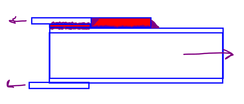

I have a condition where due to a fabrication error, a very heavily loaded brace now has a 1" gap between the typical flange plate connection and the brace itself.
The contractor is asking us if a shim plate can be used to fill the 1" gap (see red shim plate) to prevent ripping it out and starting anew.
The load in the brace flange needs to flow into the shim plate and then transfer the load into the original brace flange plate. We have a very big 1" fillet weld connection in the original design on (3) sides of the plate. Does this red plate need to have any sort of strength? It feels like the load path is quite direct, in that the plate never goes into shear or tension and the load "flows" from one weld to another, with the plate just providing a welding surface to make the flow happen. Is there anything I should be checking on the shim plate?

I'm curious how load "flows" through a material without inducing shear (direct or torsional) stresses or normal stresses (axial or flexural). It will absolutely need sufficient strength to transfer the load. Draw a FBD of the entire connection filler plate and you'll see the load path and can design it accordingly.
For a 1" plate the max weld size is 15/16". This applies to the bottom figure, top weld.
I would check the red plate for block shear. The strength will be high, but you said "very heavily loaded" and it's just over half as thick as the 1.75" plate that the original bdesign is based on.
What is the magnitude of the load and the dimension of the W section? If you can develop the force with 15/16 weld by increasing the size of the plate, I wouldn't normally worry about the fix, the added eccentricity is relatively small.
I think that you'll be fine with this. There's some tension lag, in theory, but the welds on the two faces of the filler plate are so close to one another that won't add up to anything appreciable. Ditto for the added eccentricity in the plane of the brace web. pham's right that there will be some short lived shear in the filler plate. You can check that easy enough but, realistically, it will probably be a non-issue given that you'll have already checked your weld for base metal shear failure.

KootK- I'm not so sure that it'll be a non problem given the OP's original suggestion that the load will "flow" without causing shear. What kind of steel is that plate made from? For A36, a quick back-of-the-napkin check suggests base metal shear controls over weld size for a 1" thick filler. That means that eccentricity between the welds on either side may not be so trivial.

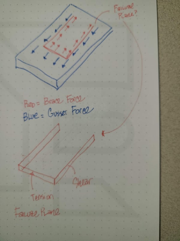

FBD of the shim below, I guess I see a sort of block shear plane that needs to be accounted for.

We were planning on 50ksi plate, but at 1/2" max plate, the block shear strength of the failure plane I drew is about 650 kips ultimate, not enough.

eccentricity would be negligible for that size section IMHO. Use whatever size plate you need to 'fill the space'. Space permitting, it's just a matter of designing the weld for the loading... there should be no issues. If a field weld, with lots of passes, you might want to check the welds.
It occurred to me on the original design that you could make the spacer plate narrower than the outer plate by whatever amount desired, then fill the gap on either side with weld metal (IE, a wide butt weld with the spacer just acting as a backup). I don't suggest that's a good way to do things, just another possibility to consider. The 1/2" plate requirement makes that more attractive. If the assembly was loose where they could rotate it, that would help, too.

A 1/2" Gr.50 PL won't work for J4 base metal checks. I would also not advise on trying to consider the gap as a CJP or PJP, the weld is not through the thickness of either joining member.
There are likely alternative solutions, though moving the flange plate to it's intended position seems like the best option.

That's precisely why, in my original response, I mentioned that it was probably okay so long as the base metal check had passed. I'd taken that as given since I know a fair bit about S&T's capabilities. Given that the welds are practically on top of one another, I feel that the satisfaction of the base metal check probably also covers block shear. It certainly wouldn't hurt to check both, however, given the stakes.
