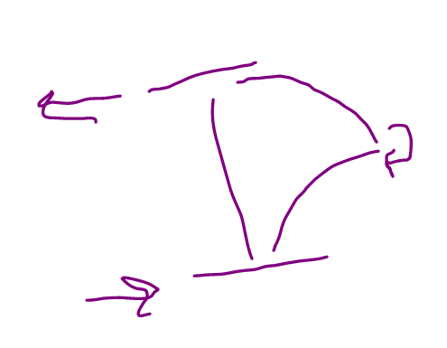

I'd be curious to know how you did that. It seems to me that you've attempted to apply lateral bracing concepts to what is, fundamentally, a torsional bracing system (I think). I see a symmetric, half model of the system as I've shown it below. That would involve flexure in the angles and the determination of the bolt force would be a more complex thing involving both the geometry of the bracing and the stiffnesses of the bracing members. Something like some 3EI/L models on the braces and determining the vector sum of the accompanying shears.

There's no sway in OP's failure mode. The braces force the top flanges to translate the same amount as the bottom flanges. The centroids remain stationary. That's pure twist, no sway.

The bolt doesn't have a rotational restraint but the joint must have a rotational restraint, as I showed in my sketch above. Otherwise, there's nothing to restrain twist of the half model under OP's proposed failure mode. I believe that you were on to this yourself in one of the comments that you deleted earlier.

The next bit of the fun, for me at least, will be working up a formula for the bolt shear. Tentatively, this is what I've got:
1) Under OP's buckling mode, there actually is no axial force in the braces. Only shear and bending.
2) The bolt shear would be [2 x F / sin (theta)]. [F] being the lateral flange restraint forces and [theta] being the angle that the braces make with the horizontal.

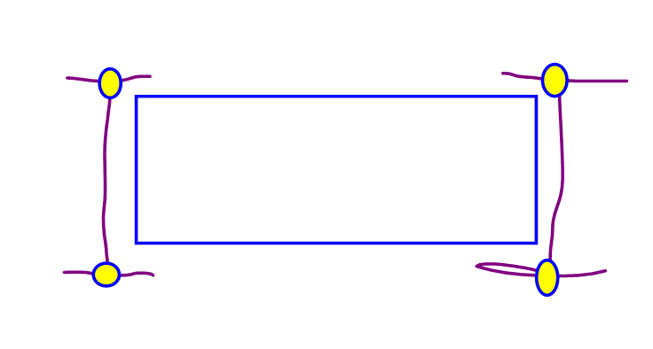

steveh49 said:
Needs more mulling on my part, but I've obviously missed some context around your statement that there's no requirement for the crossing connection given your recent replies.
The list at the bottom of my 27 Jan 22 19:26 post is probably the most concise expression of my position on this.
steveh49 said:
Just looks wrong to me.
I've come to rationalize it like this, with reference to the sketch below: for same direction twist, and only same direction twist, the unconnected braces force the four points shown below to maintain their relationship to one another (the rectangle). The rectangle can sway and rotate, of course, but the relationship between the two beams is maintained. Hence their twin-ed-ness is preserved.
