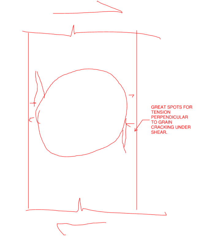

I don't love it. You also need to transfer shear across the 1/2" remainder bits in addition to the flexural and axial stresses in those locations. Even if the holes are at mid-height, there's no such thing as a uniform wind load in real life. It's likely not an issue for such a short stud but I'd have to think that you've probably also lost half of your strong axis flexural stiffness in the studs as it would pertain to axial buckling.

To push that a little further, in this situation the shear would also add local flexural stresses to the remainder bits because you can expect the thing to act Vierendeel-ish across the hole.
In a fundamental, theoretical sense, I feel that the scale of things at the remainder bits is so small, and so dissimilar from Bernoulli principles design, that the basic M/Sx stuff doesn't really even apply. Across a hole that large, it's a joint, not the cross section of a conventional flexural member.
I'm not even convinced that the 1" angle is a good reinforcement choice but I guess that I'd need to see the details.
When I imagine the vierendeel action, I kind of envision this happening.
Another thing to consider is that with typical wood setups, accidental eccentricities are ever present. It wouldn't surprise me in the least if 2/3 of your axial load ends up on one side of the stud.
