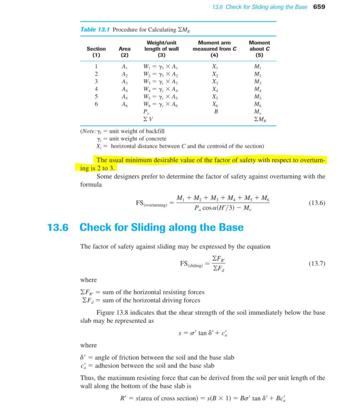

I am working on designing a foundation for a jib crane. [highlight #FCE94F]The jib crane is 16 ft tall with a 24 ft cantilever arm. The maximum lifting capacity of the crane is 3 tons.[/highlight]
From CRSI Design Handbook 2008, it mentions to use a Factor of Safety (FOS) of 2.0 for Overturning, see image:
A FOS of 2.0 is also mentioned in Principles of Foundation Engineering, 8th Edition by Braja M. Das:

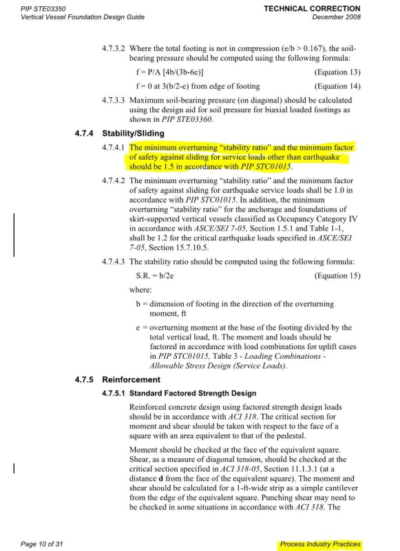

However, it seems PIP mentions the use of FOS = 1.5 or 1.2 for overturning, see images:

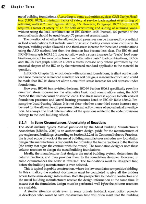

The only explanation to these various FOS I could find is mentioned in the Foundation and Anchor Design Guide for Metal Building System by Alexander Newman:
For my particular situation, what would be the appropriate FOS for overturning to use for a jib crane foundation based on the crane description I provided above?
I am inclined to use FOS[sub]overturning[/sub]=2.0, but I would like to have justification for my design which ever route I go.

I think the difference in "safety factor" is mainly caused by the use of Non-factored load (as in ASD) and factored load (as in LRFD). At the time of ASD, the factor against rotation was usually 1.5 for normal cases, and 2.0 for cases with elevated uncertainty.
How certain are you of the loads? If I know my loads are very conservative then I'm OK with 1.5. The more uncertainty in my loads, the more I tend to bump up the safety factor.
You're comparing jib crane recommendations to pressure vessel recommendations, and things like that vary from industry to industry and from application to application.

Fair enough about the jib crane being a different equipment for the vertical vessels.

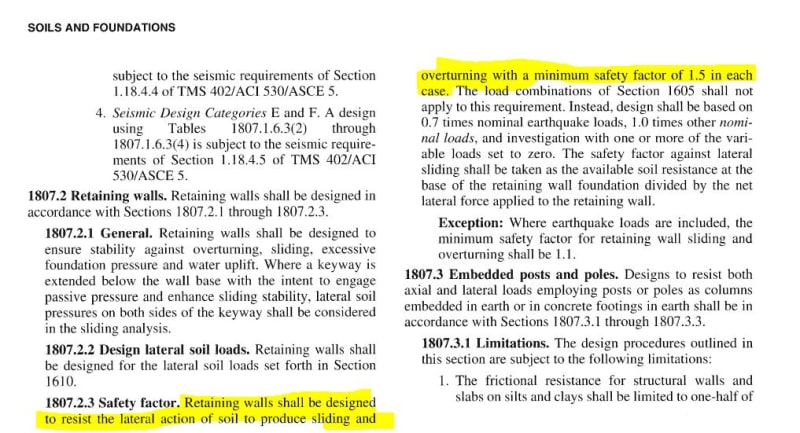

However, the PIP Structural Design criteria mentioned 1.2 & 1.0 for the FOS[sub]overturning[/sub]. This is less than what is mentioned in IBC 2012(see image):
That seems too "care-free" of a design to me, using FOS = 1.0.

PIP STE03350 is for Vertical Vessel Foundation Design however, PIP STC01015 Structural Design Criteria still suggests F.S.=1.5
(...The minimum overturning “stability ratio” for service loads other
than earthquake shall be 1.5 ...)

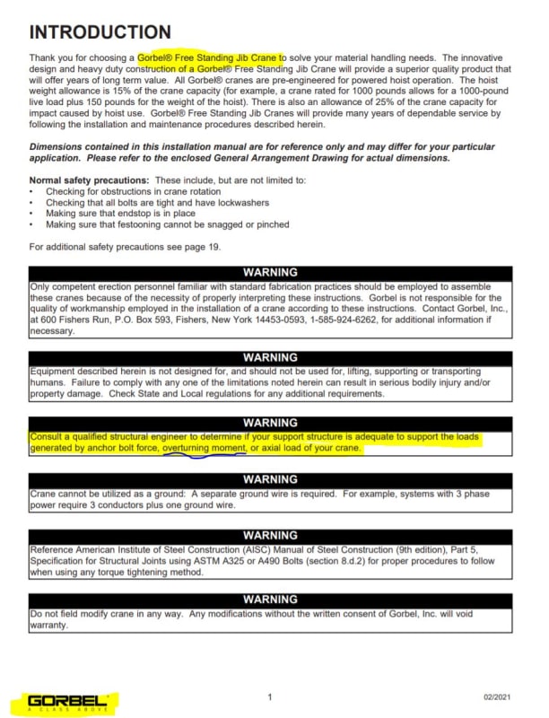

So I found some mention from the Jib Crane vendor about their thoughts on the foundation design regarding overturning moment (see image):

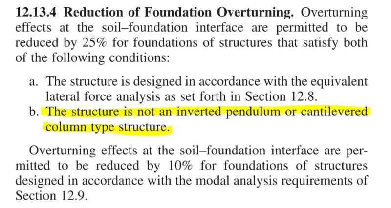

It seems to me from ASCE 7 that foundations with a cantilevered column type should have special consideration for overturning (see image):

I like how you mention that 1.5 is the MINIMUM factor of safety for the overturning moment. Due to the fact that this Jib Crane is located outdoors (i.e. exposed to wind loads - which I am not sure were considered by the manufacture) & the cantilever span is 24 ft long carrying a maximum of 3 tons (6 kips)...to me it seems a FOS[sub]overturning[/sub] = 2.0 is justified.
Question: Would you consider the vertical weight of the jib crane when designing for overturning or not include that weight as a help to resist overturning due to the capacity of the crane times the moment are of the cantilever? My initial thoughts are that the weight of the jib crane would not be effective if the crane is trying to rotate due to a maximum applied load on the cantilever arm.
You are legally obligated to follow the governing code (IBC for me). So regardless of what other publications may use for a safety factor, you need to follow the code. Keep in mind that design codes are minimums, you are free to exceed the requirements.
In the absence of a code requirement, the IBC allows you to refer to other publications for guidance that have been widely accepted. That, along with engineering judgement, should guide your decision.
My personal feeling is that I am comfortable with a FS =1.5 for all foundation and retaining structure failure modes unless a lower value is permitted by code.

Self-weight should be included in all steps of the analysis - to determine soil pressure and to determine inertia force during the earthquake.
The cited ASCE7 provision is for seismic considerations.

The self weight of the foundation & the equipment has been considered in verifying the soil bearing, sliding, & strength checks. I was just specifically thinking it would be more conservative to consider mainly the weight of the foundation itself to resist the applied moment caused by the cantilever & max capacity of the jib crane.
After further thought, I will continue to consider the weight of the Jib Crane as a ballast in my Overturning Check. This is since I would think that the Jib Crane manufacture would include a counter balance to keep the crane itself for rotating/overturning.
