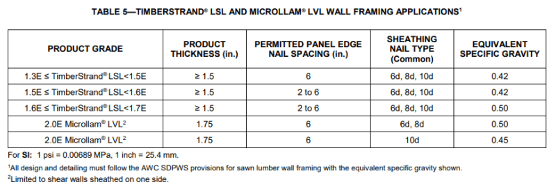

LSL studs have limited capacity for shear wall design, so if this is a tall shear wall, you may have to reconsider your wall lengths to get sufficient resistance from the lateral system.
I wasn't aware of that. Any chance you could point me to a document or something where I could find out more?

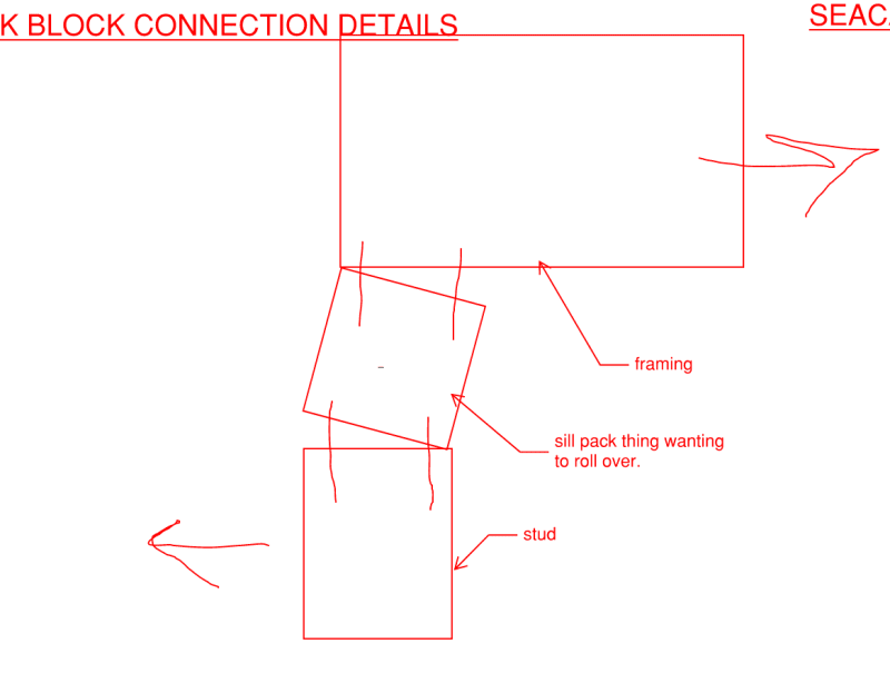

I see the SDS screws turning the stack-o-plates into a rigid-ish block which is peachy. But, then, to keep that block from rotating, one of two things needs to happen:
1) You need enough dead load to, effectively, prestress the joint. Plausible but a bit sketchy in my opinion.
2) You need to rely on your toe nailing to resist withdrawal loads. Also yuck.
I think he means under face loads, the top of the studs is 4 x top plate thicknesses below the top of the built-up top plate where presumably the roof is attached, and the face loaded shear is taken out of the wall into your roof/ceiling diaphragm.
So you end up with some bending at the connection which for 1-2 top plates is typically ignored. But for 4 top plates it's something you might want to start thinking about reinforcing for with some straps front and back wrapping over the top plate to provide some nominal bending capacity out of plane of the wall.

Yeah, Agent666 described my concern perfectly.
Sure, the only LSL stud manufacturer that I am aware of is Weyerhaeuser, as LP (who also supplied Boise Cascade) converted their mill to the production of siding, leaving the only player in the game as Weyerhaeuser.
Weyerhaeuser's code report is ESR-1387, table 5 provides the nailing and specific gravity limits for LSL studs, depending on stud grade.

Ah, I see now, so you're concerned with out of plane loads, and the transfer of that load from the stud to the roof diaphragm. Makes sense, but I'd have to think on it a bit more, not sure I agree that it is a big issue, as I assume the exterior sheathing goes all way up to the top plate, unless I am misunderstanding?

...not sure I agree that it is a big issue, as I assume the exterior sheathing goes all way up to the top plate, unless I am misunderstanding?
1) Wind load is reversible, of course. So the sheathing only assists in one direction, unless you're laying claim to the drywall as well.
2) I wouldn't classify it as "big issue" either. It's just one of several things that I don't love about the situation that inform my overall distaste for it. A bit like how I don't super hate most hip hop songs but, at the same time, I've little use for the genre on balance.
Fair point, an argument could be made that drywall may be effective (we assume it's effective for stud compression bracing), but I won't be the one making that argument.
