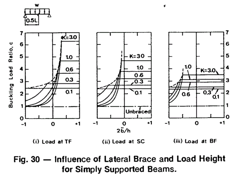

Here's a chart that gives an indication of how the level of the brace on the cross-section affects buckling capacity. These are published elastic buckling results, so you still need to feed these through your design code procedure to get a design capacity accounting for imperfections. Hollow sections would be K=0.1 (or less) and bottom flange bracing is at the left of the graphs.

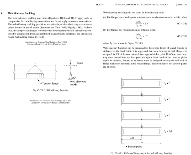

Don't forget about the good 'ol web sidesway buckling. Which I suppose is a flavor of constrained axis buckling. But it applies only(?) to concentrated forces, not UDLs. Not sure how this plays with closed shapes (HSS) though.
