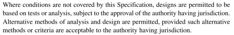

AISC 360 doesn't preclude using other fasteners. In that case, section A1 applies:
However, most U.S AHJ's require that alternative designs have a current ICC-ES evaluation report. From scanning the website, it doesn't appear that the Hilti connectors have an ICC-ES report yet. They may be able to provide you with some literature or reports that the AHJ will accept.
