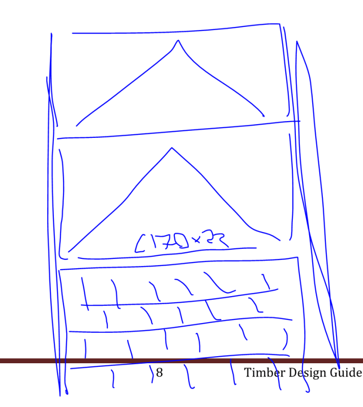

Got the situation below. I've pitched post installed anchors (Hilti HUS) for the fastening. There's a desire to use nelson studs but, presumably, those would be wet set. I'm concerned about the wet set nelson studs for these reasons:
1) Issues with wet setting anchors in general compromising capacity.
2) Not sure the grout will be well consolidated if there's a rush to get the channel on before it sets. Does bond beam grout get vibrated?
3) Contractor might not manage the sequencing and I'll be stuck detailing a post installed solution anyhow.
How do we feel about the viability of the nelson stud option?

The channel in question here is the lowest steel member in a steel braced frame that turns into a masonry shear wall. I don't love that setup in general but, alas, it is what it is at this point. Moral of the story: this thing is meant to see some real axial load.

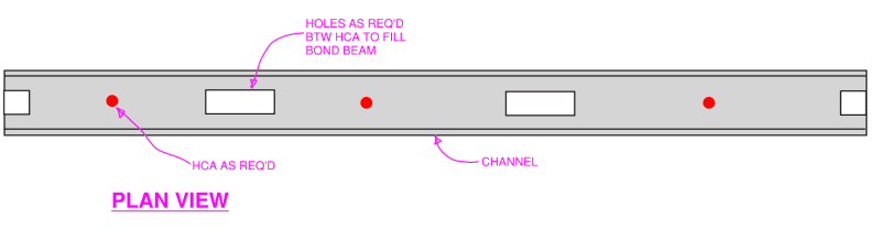

They do not need to be wet set if you let them blow some holes in them with a torch. Much easier to install that way since you do not have to lug a heavy piece of steel into place. If you are against holes, then you are at the mercy of the contractor.

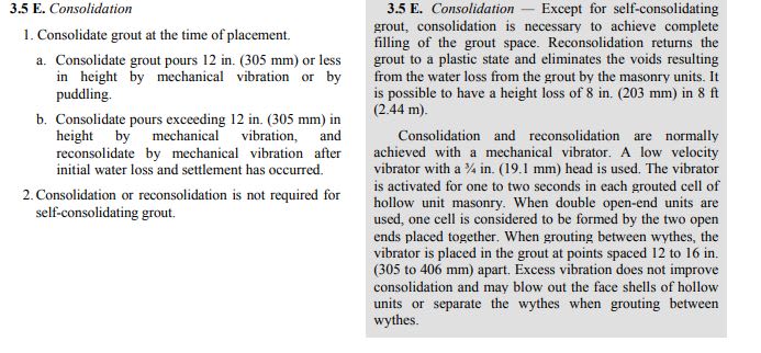

I wouldn't count on the bond beam being vibrated FWIW.
Is it supposed to be vibrated? I'm not clear on that.
I'm not opposed to holes. I don't think that I understand what you're proposing though since, even with holes in the channel, it would still be a long heavy piece to lug into place. The only weight savings would be the material removed in the making of the holes? Can you elaborate?
Set the channel before grouting. Grout trough holes in channel?
This option keeps the trades separate mason can set the threaded rods and the steel guy can come in later and slap it on.
Yeah, that's being considered. Are we not concerned about grouting quality that way though? Seems to me that would be rife with potential for voids and poorly consolidated grout. If I'm wrong about that, I suppose that's precisely what I need to know.
@Celt: that's clever but, even with the slotted holes, is that still not likely to be a coordination challenge?
It will still be a coordination challenge however in my opinion it's less so than having a mason wet setting the channel. Most the time I see the grout slammed down with a 2x4 instead of vibrated as well so the threaded rod gives me more piece of mind for the attachment if this is a critical piece of the lateral load path.

I would think if you have a reasonable contractor, with oversized slotted holes and site measured anchor locations, a decent steel sub would be able to knock those holes into it from dimensions and it be on site the next day. And be close enough to tolerance that it's not an issue.
However, if going to that much hassle, may as well just do the screw anchor post installed solution you were originally planning.

MasonryGeek may have more insight but as far as I know the positions of the NCMA, and generally speaking, all grout needs to be aided in its consolidation unless it is SCG. If the pour is less than 300mm it can either be mechanical or by puddling, but beyond that it must be mechanical. I don't know of any exceptions for bond beams on this.
MSJC commentary on Masonry Structure Building Code Requirements

Gotcha. Well then. I like Brad's idea with the grout holes. I'm not a fan of wet setting anything. In grout or concrete. I also like the top two courses as a cast in place/formed "closure" beam after steel is in place.
Or just insist on the post installed anchors. Surely they can suffer an hour's labor of drilling.
For that arrangement, I'd probably lower the work point of the braces and block out the ends of the wall for the gussets. Lap the wall reinforcement with the gussets and weld.
