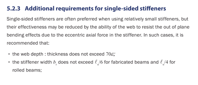

Can you elaborate on your concerns? The obvious complication is the twisting of the unsymmetrical tee that adds stress to the flange.
Yeah thats it exactly, you're effectively trying to bend a top/bottom 'tee' (which is really similar to an angle), about a non-principle axes. Not to mention the whole compression/tension centroid being offset from the web.

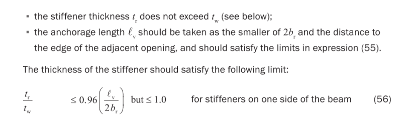

This is what P355 had to say on the matter of single sided stiffeners located at the top/bottom of the hole, and the concerns around the non-symmetry of this scenario. But these recommendations are on the assumption your flange is symmetrical.
Can you give me a hint about what epsilon is, and what expresson 55 is? Thanks...
Dik you can download the full guide here.
Epsilon is a scaling factor for yield strength.
See page 65 for the eqns 55, it's basically a number of checks to determine the minimum anchorage length for any stiffeners beyond the edge of the opening.
