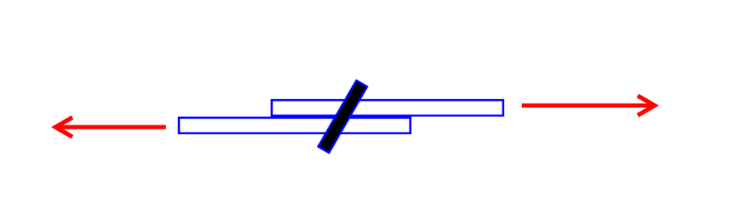

4) In reality, I think that these two things help your situation:
a) Fastener plowing should be pretty ductile, even if it introduces some slop into your uplift mechanism.
b) When the plate elements tend to slide past one another, the fasteners rotate in a way that probably allows some slip before serious fastener resistance kicks in.
5) Practically, there's just no way to make a go of these setups if the fasteners have to take all of the bearing loads.
Thank you very much KootK for the detailed explanation.
"b) When the plate elements tend to slide past one another, the fasteners rotate in a way that probably allows some slip before serious fastener resistance kicks in."
Can you elaborate a little on this affirmation, it's not exactly clear for me how to imagine this?​

See the sketch below.
@rowingengineer: thanks for the video, that's a great contribution.
Wow, thanks for the video @rowingengineer and also for the sketch @KootK everything is clear now :)

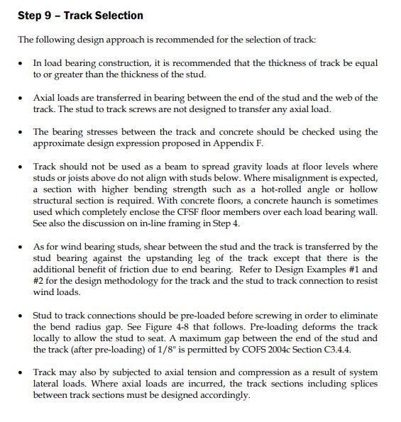

Also I found this:
This means the connection should be preloaded to get the axial loads transferred directly between the track web and stud. How could they do that in the factory when they pre-assemble a single wall pannel?
Um, how do they do that in the field?
Good question. I haven't done load-bearing steel stud on any of my projects. We've talked about it in office as a couple people have and they indicated theirs were all shop fabricated and erected on site.
I have seen them placed on a floor and blocked in place.
Then small hydraulic jacks are used to deliver preload.
There is a heavy beam at top and bottom to keep things straight.
Did LGF design for 20 years. Never saw pre-compression done in the field with stick framing.

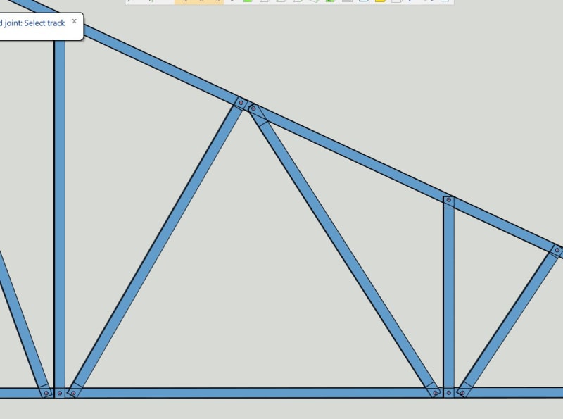

How about a truss made out of LGS? I think here we have to consider that the axial load is taken entirely by the fasteners, do you agree?
Yes, however these are mostly axial loads the the web's don't see as much. Here you design the fixings to take the load, maybe add straps or similar if you need too.
Nobody builds trusses like that. The members are oriented strong axis with the screws taking all the shear.

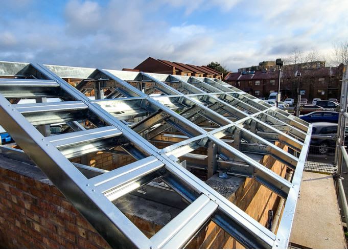

Agreed with XR250. Actually with his good advice a few months ago I designed / built a few different types of CFS trusses for various stairwell enclosure configurations. Screws transfer forces in shear as he noted.
Here's one of the roofs to give you an idea:
Looks like it should hold 20 ft. of snow!
The firm, where I started just this year, does this "in plane" trusses, like in the drawing I linked. We only do out of plane trusses if the openning is too big.
Which is the disadvantage of these kind of trusses, except of the smaller moment of inertia?
