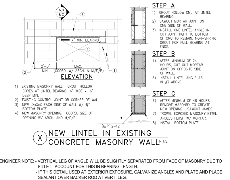

Hi everyone,
I am an EIT working toward my stamp. I've been working at this company for 1.5 years on mostly small commercial projects. I was given a new project where a homeowner wants to cut a 3' door in his existing basement and build an exterior stairwell to access the basement. My boss said to try coming up with something on my own without her help as a challenge, and I want to do a good job. I've talked to a couple of builders I know, a couple EIT friends, and have consulted Google. So far I have seen 3 options that appear to be used most often for this type of project (see below). Do you have any opinions about what option works best? I am leaning toward Option #2 since it seems like the least amount of cutting that needs to be done, but it still leaves some concrete above the opening (not sure if that matters maybe for shear flow from the framing above?). With Option #2 would I consider the concrete above the opening capable of bearing the loads from the walls above, or should I size the steel angle for the full load and discount the concrete? Should the angle be 8x8 so it fully supports the 8" thick foundation wall? Would Option #3 be better so I can just size a header for the full load?
I'd appreciate any feedback you could give. Thanks!

First I would verify with the owner that the foundation wall is actually concrete and not CMU block especially since you're saying it's 8 inches thick. Don't take their word for it, visit the site yourself or ask for clear photos showing exposed concrete aggregate faces.

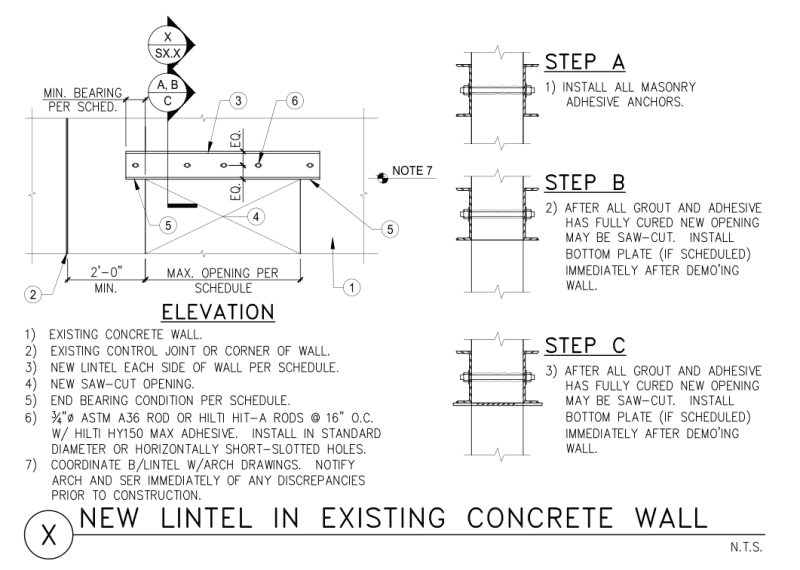

If it's CMU block masonry see below for our typical detail. If it is actually solid concrete, we typically go with concrete lintels above openings to match the existing concrete material already there. The concrete wall above is very stiff and will likely crack at corners as mentioned above before it puts bending into your angle. If you still really want to stick to steel reinforcing, I would go with something stiffer like the second detail I've included below. These details avoid the use of temporary shoring of the area above.

If it is concrete and only a 3-0 door, you may not need any lintel. Check the capacity of the band spanning across the opening. The angles seem excessive in detail #1. If you need to brace the foundation for out-of-plane, use the new stairwell walls.

I thought about this, but wouldn't there need to be a minimum amount of reinforcement in the concrete header? Since I don't know what's in there as far as rebar, I didn't think this would be allowed.

I'd start with XR250's suggestion - treat the remaining concrete above the opening as an unreinforced concrete beam per Chapter 14. Also ensure that the shear demand is less than 1/2 the unreinforced shear capacity per 9.6.3.1.
