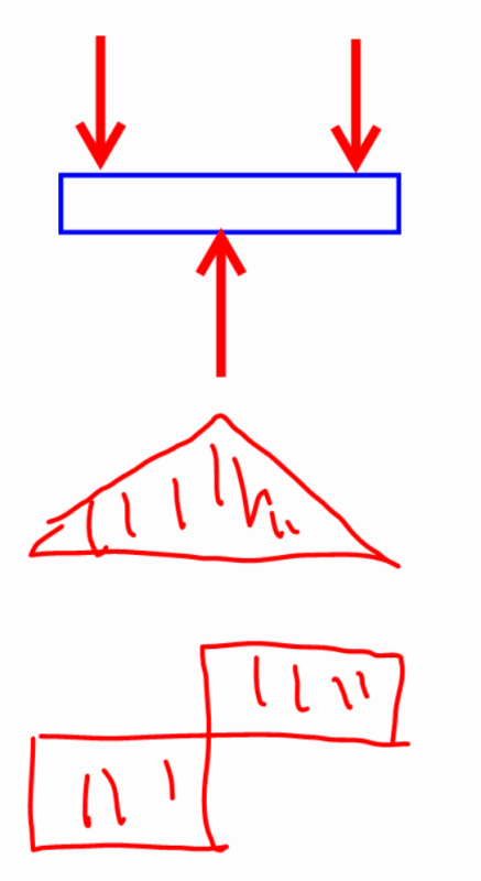

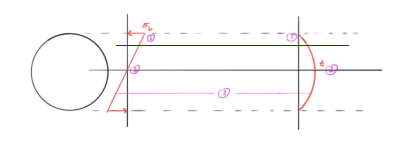

Perhaps. The first sketch below shows the model that I go to first. There are fancier ways to look at it, as shown in the second sketch, but I see little value in debating the merits of that until OP post's his own free body diagram, if he chooses to. My intent here was simply to point out one possible nuance that OP's professor might be trying to tease out of his students on this assignment. Obviously, I know no more about the assignment than OP has thus far shared.
What load distribution have you been assuming that would have no instances of significant shear simultaneously present with significant flexure?

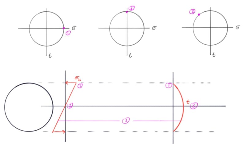

I believe rb1957 is referencing the internal stress state resulting from the shear and moments. Which I agree that the stresses don't interact but only at the locations of peak shear or peak bending stress at all other locations through the section depth the stresses do interact in the von-mise combination.
Agreed. One would be concerned with the stresses at, say, the blue line shown below.
These two things will be true of pretty much any elastic section in:
1) Flexural stresses will be at a maximum at the extreme fibers.
2) Shear stresses will be zero at the extreme fibers.
Obviously, that cannot be taken to mean that we never have to worry about Von Mises stresses.
