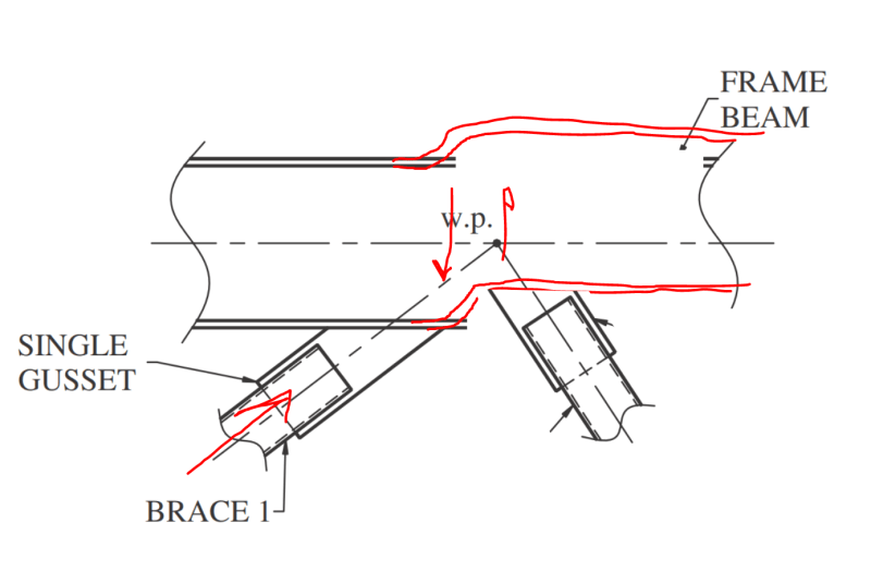

Hello all,
Anyone did chevron brace connection with split gusset as shown in the attachment? Typically we use single gusset where both the braces will be connected and then we will calculate the forces at section a-a (gusset to beam interface) and section b-b (vertical section of center of gusset). However due to the slope of the brace, we need to split the gusset into two instead of using the single large gusset. In this case how we will calculate the forces and check the connection? Any design example or reference will be appreciated.

Calculate them as two single gussets. Watch out for additional bending moment in the beam and additional LTB effects from loading the bottom flange.
Alternately just connected the two braces in once gusset. That is what I would do. The consequences of moving the work point down the beam and closer to the flange are general not of notable concern.

I agree with human909 across the board, including the preference for non-concentric joints in some situations:
1) This can be done and has been done.
2) For the most part, it's two independent connection designs to be checked for all of the usual stuff that the single gusset connection would have been.
3) There are some nuances, in my opinion, that are a function of the tiny bit of vierendeel action that you can now expect across the node (shown below). That implies some local moments, as humun909 mentioned, as well as the need to take 100% of the nodal vertical shear across the beam which which is likely not a big deal unless this is a high seismic thing following capacity design principles. These tendencies also exist with a single gusset with the difference being that, in that instance, the gusset is there to help resist the shear and stiffen the section against local bending moments.

Yeah, you'd pretty much have to yield the beam web in shear before you'd develop any appreciable moments I think. And, even at that, it would still be a flexural stress distribution within the "node". With or without a split gusset, I feel like what's going on within the node is a bit of a crapshoot short of FEM modeling.
