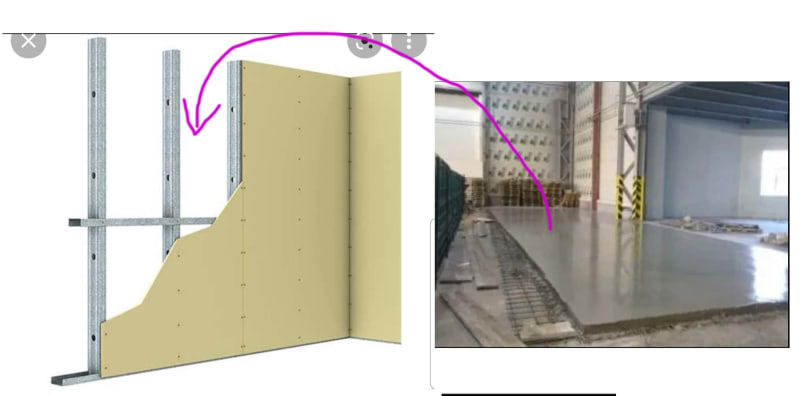

Screed or mortal mix made up of cement and sand are very hard to chip off from floor especially if there is a wire mesh underneath the screed/mortar.
Which begs the questions. What would happen if say 4" of mortar (made of cement and sand like used in screed without any gravel) with wire mesh at the middle layer were welded to non bearing wall made of thick stubs that are anchored well below and above (see illustration above).
I just want to know what is the behavior of this thick mortar wall. The wire mesh or even very small dowels can have dowel action effect. Is it not? Without any gravel. How big can pieces of mortar just drop off between the wire mesh or small rebar mesh if they would be distance let's say 6 inches apart?
Or in other words, how many inches can dowel action work on mortar mix only? (I'm aware aggregate interlock in normal reinforced concrete are strong because of the aggregate interlock) but it is non-bearing wall only with fully anchored vertical stub support distant 23 inches apart (between thick vertical C-purlin stubs 2x4")).
Thank you.

What kind of behavior are you considering? Diaphragm/shear wall? Flexural? Between studs probably wouldn't do that much for you. The NDS and, I believe, the AISI documents for light gauge studs have shear wall capacities for plaster on lathe wall assemblies - which is essentially what you're describing but with a different cementious material.
I think you'll end up with significant ductility issues. Small drifts will cause this assembly to crumble and cyclical loading would result in rapidly increasing deflections and failure.
Maybe I'm not understanding what you are trying to do. You show a metal stud wall, and then you show a floor slab and an arrow connecting them. I was under the impression you were thinking you could install some form of dowels from the wall studs to the mortar/screed. I also assumed the mortar/screed was being installed on the face of the wall in the final configuration and you were asking if that improves the wall stud capacities.
You further talk about dowel action. What are you trying to build? How do the dowels relate to the wall studs? Are you filling the cavity between the wall studs with mortar/screed? Why?
Remember, none of us have the information you do regarding the project in front of us. We don't know what you're trying to build, or why you're trying to do what you are. Explain the end goal, explain why you are trying to do what you are. Include some hand-sketches or something of sections so we can understand what you want.

It won't work. You have incredibly efficient thermal bridges spaced at 24" o/c or less. That's why stud wall fire wall systems have something outside of the studs - you want a continuous barrier with little to no thermal break in it.
And "light" is relative. A solid cement/sand wall is still going to weigh a whole lot more than a hollow wall with a couple layers of type X gyp on it.
Agreed with Pham. I don't feel that is the most optimum way to provide the fire protection. There's a reason it isn't a common construction technique.
Even with only mortar (which honestly isn't substantially lighter than standard concrete) your wall will still weigh close to 2-2.5 kN/m^2. A steel stud wall with double type x on each side only weighs 0.7 kN/m^2 conservatively, closer to 0.5. That's substantially lighter than the screeded wall.

What level of protection is required? You can get 1 hour out of 16mm type X gypsum, 2 hours out of 2 layers.
The steel studs will provide direct heat transfer from one side of the wall to the other with your scenario. That to me is less protective than the drywall.

If you're going to cover the wall in gypsum anyway, why bother filling the cavity with mortar? You're now increasing weight for no benefit.
Where I practice, the wall construction from a fire rating standpoint typically has to meet some codified wall type. So in your case, they would only consider the gypsum board and studs, the mortar fill is just additional dead weight.
So not only are you making that wall much more complicated to construct, but also making it heavier meaning the structure below may need to be beefed up. For what? In my mind, no benefit.
I can see that there really is no dissuading you. And I don't have any sort of testing like you're requesting, because I've never seen a wall construction like that proposed for the reasons we've already indicated. So unfortunately I'm going to bow out of further responses.
Maybe the contractor on the project will have better luck changing your mind once you see the additional price tag associated with it.

The whole point is to not let the studs melt as they are inside the gyp board. There are rated/tested/approved assemblies of metal studs and gyp board that will provide up to 3 hour protection. [URL unfurl="true"]https://www.usg.com/content/usgcom/en/design-studio/wall-assemblies.html[/url]
You're not planning on specifying this mortar wall thing on a project are you? Like others have said, it's just a heavy wall with no benefit. It seems like your mortar wall would just be a hazard to firefighters in case of a fire, on account of having large panels of mortar just waiting to collapse.
Just use a rated wall assembly. By the time you build a metal stud wall and fill it with mortar somehow, you could have just built a concrete or masonry wall.
Not to mention you'll never get a building permit if you specify this mortar wall and call it a 2 hour firewall.
