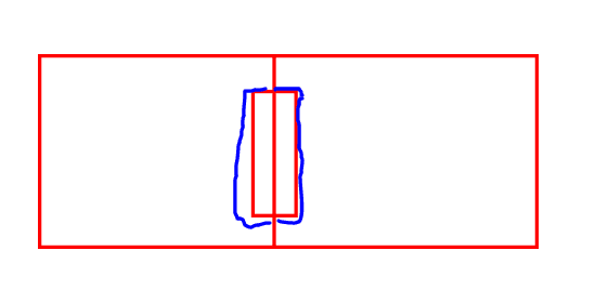

I have a question regarding a built up section. I am attempting to increase the capacity of a crane from 3 tons to 5 tons. The crane runway beams need to be reinforced. LTB controls, so I am adding web plates on both sides to create a box section.
Existing runway beam:
W21x62 w/ C12x20.7 cap channel
52' Span
Reinforcement:
1/4" web plates each side of web full length
If web plates are only 10' in length(required from fabricator), do I need to provide a CJP weld at the butt joints of the web plates? Is it possible to not have a CJP weld at the butt joints? Would a PJP suffice?
My initial thought is that a CJP would be required at the butt joints to provide the same section properties throughout the beam. Does anyone have an explanation that would justify CJP welds are not required?

It's certainly possible from a mechanics of materials perspective. All those welds need to do is resist whatever vertical shear winds up in the plates as result of the LTB demand and whatever direct torsion you need to deal with. So long as it works for fatigue, which is important, I imagine that just about any weld would work for strength concerns.

You can use a cjp at the butted plates, but it will be a more tedious fabrication detail. For instance, B-1a-GF would require internal backing to be abandoned within the built-up section. Unfortunately, the butted connections can't be reached for backgouging, unless you know a welder with 10' arms. If it can handle your loads from first principles, a butted joint w/ a BTC-P4 PJP would be preferable for a fabricator.

Your weak point isn't weak at all. Truly, if it were not for fatigue issues, I'm sure that a 1" seal weld in the middle would do the job. That, particularly for the LTB case as that's a second order kind of thing that will produce a very small torsion demand. If your PJP satisfies your fatigue detailing, that sounds like a good solution.
Mechanically, you could even just fillet weld a shear splice plate to join the adjacent web plates. I'm not sure that would be kosher for fatigue though. Perhaps someone with more crane experience, like dik or FLCraneBuilder can comment on that.
