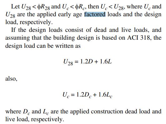

I'm having a slightly difficult time understanding your assumptions and following what it exactly it is you are doing. If you could walk me through exactly what your loads are floor by floor and how you're assuming they'd be distributed that would be great.

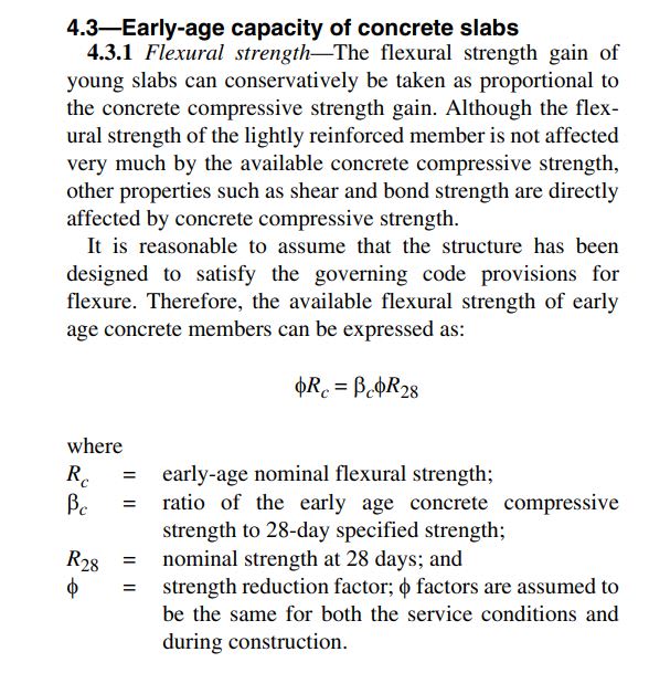

In general reshoring is based on the so-called simplified method (see ACI guide below). Basically it assumes that the shoring/reshoring is infinitely stiff relative to the flexural stiffness of the slabs, loads are distributed uniformly (be careful about this one), and that loaded slabs will take load in proportion to their flexural stiffness (though assumes aging effects are moot on this front).
So if your top slab has 100psf DL, and you apply a 50psf construction load then you sum that number (after multiplying by appropriate LL and DL safety factors) and divide by the LL capacity of the individual slabs beneath. Round to the nearest slab. Note: you need to take in account if the designer has applied a LL reduction which does not always accompany the stated LL.
What I'm getting from your case is we have a total factored load of 1.2*(100) + 1.6*50 = 200 psf to be resisted by floors with a capacity of 1.6*40 = 64 (assuming all the floors are at 28 day strength if not you need to ratio the capacity). You would need 3.13 floors. You would probably round to 3 in this case but if it's your first rodeo go to 4. You use factored loads like anything else you would design.
BTW if you haven't read it please grab yourself a copy of ACI 347 Guide for Shoring/Reshoring of Concrete Multistory buildings. It presents assumptions of the simplified method and is quite detailed.
As for your question 3: when you have non-uniform loads you simply calculate the max stresses imposed by that load as you would in original design. If it's less than the design stress you are good to go and if more than the design stress you connect more slabs!
