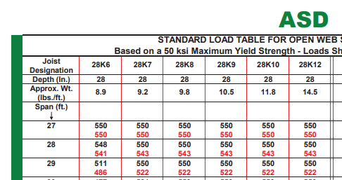

Designation for standard K-series: 10K1 to 30 K12 (depth from 10" to 30")
The number after is the chord designation. Look at the load tables - you'll see 16k2 through 16k9. Each one with a higher capacity and higher weight of steel.
You have a couple of choices in steel joist design: you can design it, or you can leave it to the manufacturer. If you design it, you select a standard joist from the load table and call it out (16K4 JOISTS at 4'0" o/c). If you leave it to the supplier, you say "16" DEEP OWSJ BY MANUFACTURER, Maximum Spacing = X, Refer to Sheet YYY For Loading" or something like that.
The "10" in 16k10 specifies the weight category of the particular, 16" joist specified. A 16K10 is a heavier, higher capacity thing than a 16K8 for example. The second number is not indicative of the number of joist spaces.

I would be careful of referring to the second number in the "joist designation" as the weight category. Maybe the capacity category or PhamENG's chord designation. The weight per foor is on another line in the table and does not have a close relationship with the second number of the "joist designation. i.e. 16K10 vs 16K12
I get what you're saying but it sounds like hair splitting to me. That's precisely why I said "weight category" rather than just "weight". The higher numbered joists from any one supplier will tend to be made of beefier stuff and will tend to weigh more. I don't see the nonlinear nature of that relationship requiring any great duty of care. That said, I do like the greater precision of dold's "capacity group" and will try to remember to use that in the future.

I agree, it is hair splitting but I think it is significant hair splitting. There is almost no relationship between the second number in the Joist Designation and the weight per foot of the joist, except that as the weight per foot goes up so does the second number.
It is too easy to try to conflate the joist designation with the steel shape designation and confuse the second number with the weight per foot of the joist.

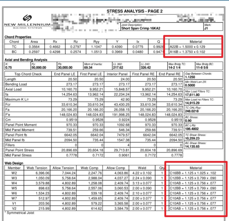

For what it's worth regarding the 'second number' (capacity group, if you will) - I've spent a considerable amount of time looking into this in the past when I was doing a ton of retrofits. I've scoured the internet for old references, design manuals, manufacturers literature, documents from SRE's website, on and on. There's no direct correlation between the 'second number' and any specific chord profile/section (with a few exceptions from specific manufacturers decades ago). For modern/newly fabricated OWSJ it will always depend on the specific spans and a variety of other factors, and they are designed squeak out every ounce of material. That's why you'll always see "approximate weight" as opposed to an exact weight. Furthermore, the shapes that joist manufacturers use for fabricating OWSJ are non-standard or in-house special rolled angles that are designated in increments as small as 1/64ths or 1/32nds of inches, typically specified in decimal inches. I.e., a specific joist might have a bottom chord of LL1.375x1.375x0.102, and a top chord of LL1.5x1.5x0.129, for example. Here's a clip from some joist calcs.
.077? Yikes.
That's under-rolling a 5/64ths angle. I'm designing with a crayon and they are cutting with a micrometer.
