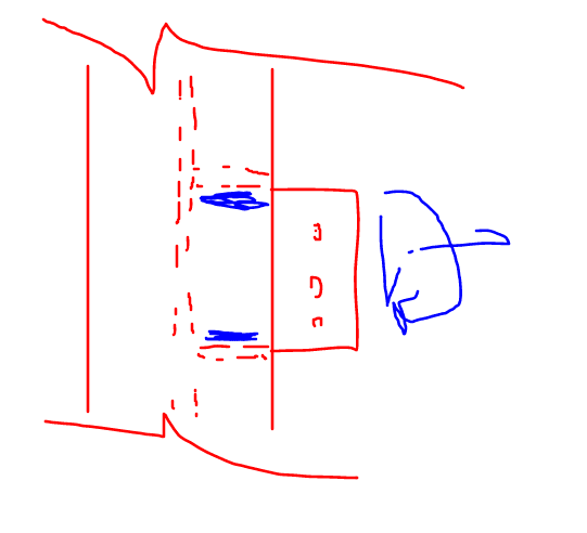

I'm with the steel fabricator on the welds when the stiffeners are included. In my mind, the 5/8 business is predominantly about developing the flexural strength of the tab when the amount of moment that tab will see at the support is high or difficult to ascertain. With the stiffeners in play, any moment or axial load on the tab will be drawn to the welds shown in blue below. Thus, they don't need to be considered at the weld between the shear tab and the column.
