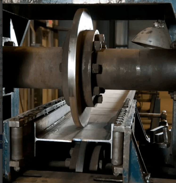

The equipment to cut out WT out of a WF is not your average machine. Even the smallest shops have 5'x10' + CNC plasma tables these days, but that will not work for anything but flat stock. To cut this efficiently they need a milling machine like Mill Machine That will be found in a large shop, but they will have minimums before they will even talk about a job like this.

Brad - that's nuts. Thanks for sharing. Really cool stuff.
I think the most efficient web is how Canam or others do it. They buy the stock in rolls or sheets, cut with a shear, and roll as needed. A shear is fast, and not overly expensive. Equipment to roll the shapes is not crazy either. You need to be a large producer to play in that game given the margins. We will wait and see if others have more useful practical experience. I have worked with a few shops that have Voortmans, but not a ton. Many we work with are still fairly old school.

There are many ways to create WT's.
Enable hit on some of the "simplest" ways above. Depending on the cutting method used, you may have a bunch of different issues: If cutting with a torch or plasma cutter, the high heat input will result in excessive camber - this is corrected by heating the flange side of the WT as well to bring it back to straight (or at least within tolerances).
If your cutting method results in too large of a kerf, one side of the wide flange may be outside of spec (stem too short) and you only get one WT per W section instead of two (perhaps the too much waste that XR250 was talking about).
As Brad 805 said, the most efficient (at scale) way to create WT's is by shearing them, this results in minimal material loss and minimal heat input, giving you the best product without needing any post processing.
The fabricator I worked for did not use WT's very often, but when needed they would buy the full W section and split them - I don't believe any of their regular suppliers offered WT sections.
I believe we charged around a 25% premium for WT sections. So if your fabricated cost was $2.00 a pound for standard shape stuff, it would have been $2.50 per pound for WT's. However, if you had a project that was using bunches of WT, I imagine one would look to get someone like Infra-Metals (link above) to supply the WT's and this cost *could* be reduced.
The best way to get the most competitive pricing would be to find a fabricator that is regularly using WT's and has a good relationship with a supplier like Infra-metals who has the specialized equipment for splitting the beams (or has it themselves). If this is the case, I imagine the premium gets quite small - perhaps in the 0-10% range.
