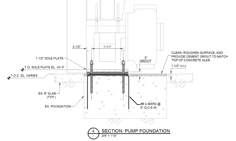

I thought it wouldn't be appropriate for my first post to be massive, but I could use some technical assistance. I'm designing a 'partial' foundation for a 250 HP pump. I say partial because we are reusing an existing 2'-8" deep foundation from an old pump, though I still need to analyze it for new loads. This is my first design for a foundation supporting dynamic equipment. (I am aware of ACI 351.3-18 but do not own a copy.) Below is a list of items I have or am planning to consider in my analysis and design. Would someone let me know if I should modify my list? It has occurred to me to contact the pump manufacturer about some of this, but I haven't done that yet.
Checklist:
- calculate forces on foundation and anchors from pump torque and thrust (I am factoring these forces by 3 to account for any harsh startups or other dynamics)
- compare concrete mass to equipment mass (a senior engineer I used to work with told me to size equipment foundations to be 2-3 times the mass of the equipment to mitigate vibration)
- design adhesive anchors per ACI 318 Ch. 17 (I have a Mathcad sheet but also plan to use Hilti Profis) (I'm assuming F1554 Gr. 36 threaded rods with snug-tight nuts and washers.)
- design sole plate beneath pump base for bending (assuming it loses contact with grout)
- determine installation details such as providing leveling screws or jam nuts to level sole plate; and providing a grout hole in sole plate
- spec grout (need to research if cement or epoxy grout is better suited here)
- check existing concrete foundation for shear, bearing, and possibly bending
What am I missing? As I get farther along in the design, I can provide more details and values. Thank you!
Get a copy of API 610. It has a lot of good practices for pump foundation, grout, etc... and has a very detailed checklist that you are looking for.
I don't think you need a sole plate. But check with your Rotating Equipment Engineer if your plant normally use sole plate for pump. We usually don't.
We usually use epoxy grout and also fill the pump base/skid with epoxy grout. This can be expensive and better check with your rotating equipment engineer.

Soil bearing pressure. It probably won't govern, but should be checked. The weight of the pump, the overturning due to vibration, and the lateral force due to vibration should all be considered.
DaveAtkins
I wouldn't consider using adhesive anchors for a pump this big. Whenever vibrating equipment is involved, I recommend using cast-in-place sleeve anchors, or a sole plate with welded studs to match the bolt pattern of the mounting flange.
The problem without using sleeves is that the bond between the concrete and the anchor is critical to ensuring that the anchor is adequately pre-tensioned. Once things start vibrating, that bond becomes broken, and it compromises the pretension. This can lead to long term maintenance issues (e.g. failed seals, excessive vibrations, worn out bearings, and etc).

CrabbyT, echoing AskTooMuch, I believe that may be more challenging since my foundation is existing. There's the option of demo and pouring a new foundation, but I would prefer to avoid that. I did read through your references and will save them, though.
If it makes any difference, this 250 HP Warman 10/8 F-AH slurry pump is going to operate at a duty point of 2500 gpm and 39 ft TDH and BHP = 82 at 402 rpm. However, I was also provided a max duty point of 3900 gpm at 80 ft TDH and BHP = 254 at 580 rpm. I've decided to calculate torque from the max duty point. I'm getting torque, T=(5252*HP)/RPM = 2.3 k-ft. If I take the advice of the senior engineer I used to work with, I multiply that value by 3 for dynamic effects to get 6.9 k-ft and then multiply by 1.6 for LRFD combo 2 to get 11 k-ft of torque. Anchors are spaced 30 inches, so the two anchors on one side receive 2.2k tension each. I'm ignoring dead load for any torque resistance. As a prelim check in Hilti Profis, I'm seeing utilizations of 35% concrete breakout and 22% bond. I'm checking Hilti's HIT-HY 200 V3 with HAS-E rod. The pump anchor hole is 1 3/8", so I believe I need to default to 1 1/4" anchor.
For a fun twist, one challenge I'm discovering is that the old pump foundation has had the top +/- 3" (or more) jack hammered away. Consequently, the #6 rebar top mat was demo'd. Not a fan. The old foundation is L-shaped, roughly 11'x11', and previously supported a pump and gyrol. Our new pump will not have a gyrol, so it will sit on roughly a 3'x3' portion. My edge distances are a bit tight, too, at 5" to anchor center at the worst. I'm considering providing a #3 tie around the anchors for shear and adding 3" grout below a sole plate. Does any of this sound concerning? I don't love that the old slab is no longer intact.
I'm attaching a preliminary section. Thanks in advance.
 https://files.engineering.com/getfile.aspx?folder=cf679745-c4c6-40b9-8334-d87496b06542&file=pump_fdn.jpg
I gave the demo'd concrete a little more thought. I'm going to have one of our maintenance guys take a long bit and drill a sample hole in the foundation to determine its remaining depth. My gut is starting to tell me that more than 3" was demo'd. I would hate to only have half of the foundation remaining. If it's thin, I'll have to cut out a chunk and repour with CIP anchors.
I would also be very suspect of using ACI design methods to anchor to a slab that does not have a top mat of reinforcing. Others will have a better understanding than me but ACI design relies on the reinforcement for concrete integrity. You can take a look at the commentary in ACI 318.

Here's an update. I was able to have somebody drill a hole in a discreet portion of the foundation and confirm that we still have at least 22" thickness remaining. However, there's still the issue of the top rebar mat (#6 u-bars at 9" O.C.) having been demolished (the vertical parts remain embedded).
Before I spend too much time analyzing this existing foundation which may or may not be adequate, would anyone care to share their opinion on the options of: 1) working with what I have or 2) demo and start with a new foundation? Please bear in mind that I'm still hovering in the conceptual phase and have not run through many design calculations yet. I would rather sharpen my axe before I fell the tree.
I have one idea and a couple concerns with option 1. My idea is to replace the top rebar mat by doweling and epoxying in U-bars each way on a grid and casting in 3" of grout. I could also install hairpins around each anchor to help with shear, if needed. My concern with the replacement U-bar grid idea is whether I can even quantity or count on it to contribute to strength or mitigate cracks. My second concern is about my edge distance of 5". In ACI 318-14 section 17.7.3, minimum edge distances of 6da for adhesive anchors and 8da for torque-controlled anchors are specified. For da=1.25", 6da=7.5" and 8da=10", so no good.
I'm starting to lean toward option 2 of demo and replace. Then I can provide adequate edge distance, appropriate reinforcement, and cast-in anchors. However, I would love to hear any takes on option 1 or 2 or if anyone has faced a similar situation.
Prelim section showing doweled & epoxied u-bars:
Your 1st option is cheaper if it works. I personally don't see why it won't work though I have not run any calculation. Demo and putting new foundation will be much more expensive. I work inside a plant and have done several of these new pump replacement and using same foundation. So far no complaints lol.
